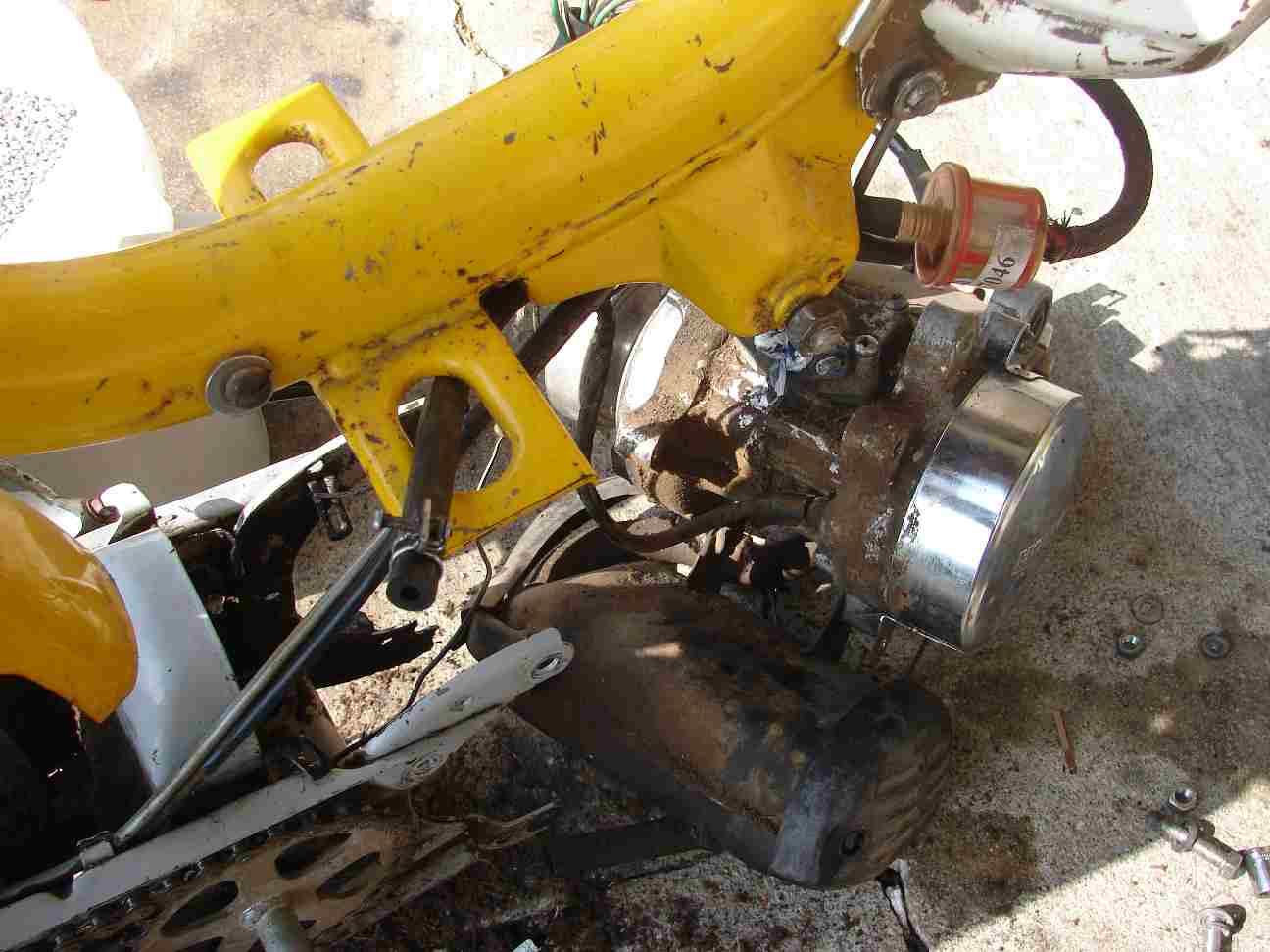

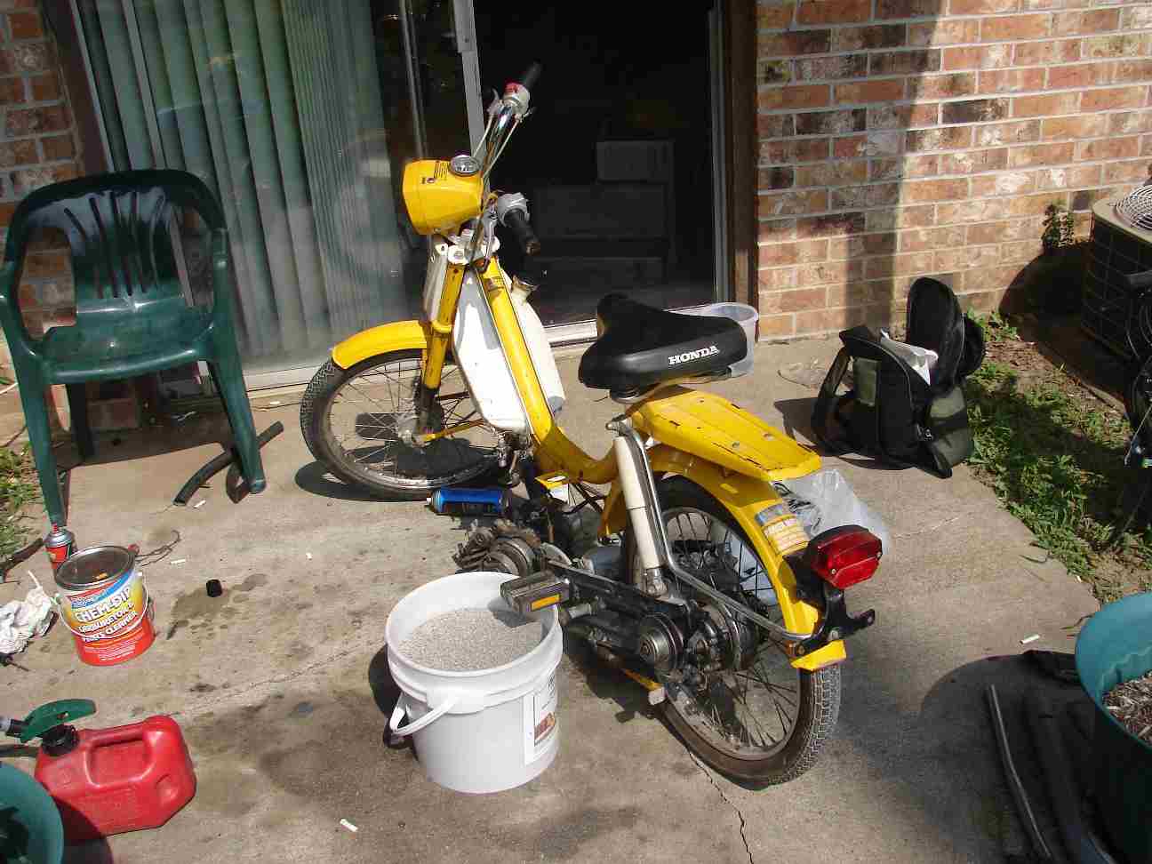

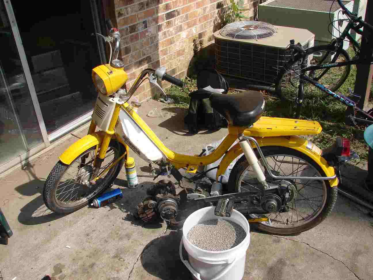

Here are some pictures of the beast as you can tell i have some work to do as the engine,carb and airbox are litterly coated in feaces...
right now in one of the pics you can see a 1 gallon chem dip bucket, that is were my carb is currently sitting in minus the O-rings. surprisingly the o-rings and the float were in rather good shape so hopefully i can cut the $14 O-ring kit from my local honda part dealer. Luckly At oreilys they had a sutable drive belt for less then $20 compared to a legitimate honda PA50-II drive belt they wanted at the dealer for $70. Wish me luck guys!
