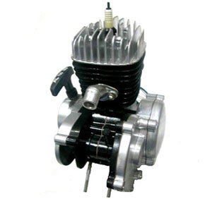

Originally Posted by Russell View Post
John,
Yes you can have a pull start just as you can have a properly setup centrifugal without a pull start. However in both cases you must have a manual clutch. What bike are you puting this motor on?
Russ
There is an HT style motor available without the manual clutch. It has a pull start and a two-way centrifugal clutch. The more common one-way centrifugal clutch retrofits retain the manual clutch.
