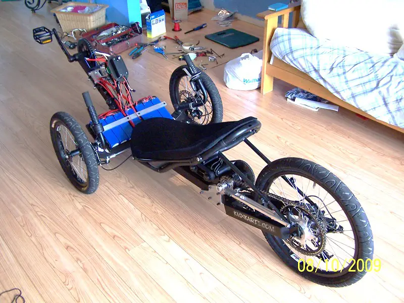

Here is a picture of one of my E-bikes (I use RC motors and Lipo batteries on all my builds).
This is a 12,500 watt twin RC motored running two Astro Flight 3220 motors, two Castle Creations HV140 controllers and a 48 volt, 30 amp hour 20C lipo pack. It runs 0 to 50 mph in 4.5 seconds if the pavement allows good hook. Normally it smokes the tire violently.

If one of those lipo's were to blow you'd have some hot crossed buns!

Just sold the trike. I have $4,000 invested in it and 18 hours of labor (much of the parts are production parts I have outsourced for me). The trike sold for $6,500!

Just a question, what kind of range do the lipos give you? Well when you're not smoking the back tire off that is.
I know when I made the switch from NiMh to 20c lipo packs in my planes I couldn't believe the power and long flight times I was getting.
