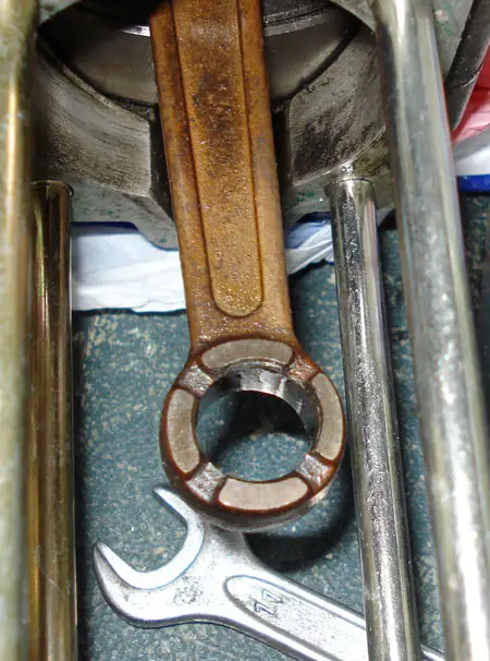

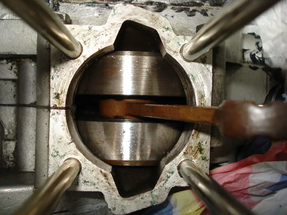

OK I ordered my parts and I am going to change the piston head and install new rings,
I checked norms 'Bicycle engine total tear down' post I removed the wrist pin but after that I do not know how to remove the piston head from the crank arm.
I am noob to this particular repair, but ready to take it on.

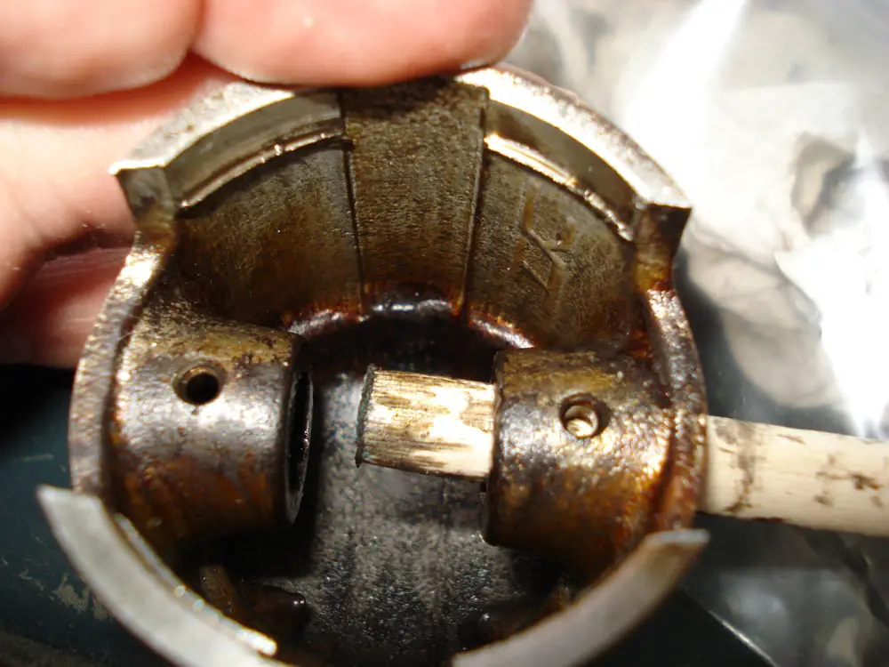

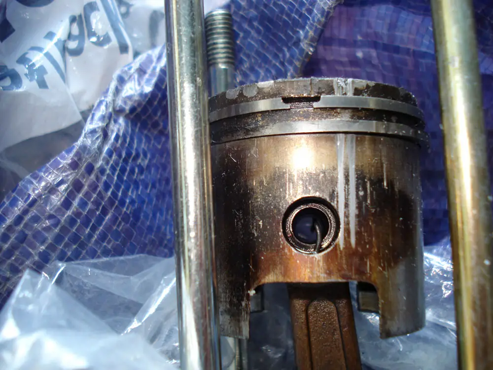

Did you remove the wrist pin keepers? You did remove the wrist pin too didn't you? You remove usually one keeper the little clip thing, and then you can push the wrist pin out on the side that you removed the keeper from if the wrist pin is hard to remove use a wooded dowel to help you push it out and you can warm up the piston by wrapping it with a rag soaked in hot water. Let the rag sit warped around the piston for a bit a couple of minutes should do it then try to push out the wrist pin you might need to remove both wrist pin clips if its hard to remove. Do not beat on it or scratch the pistons wrist pin holes.
Is your wrist pin bushed or is a needle bearing? Either way if the wrist pin is out the piston should come off.

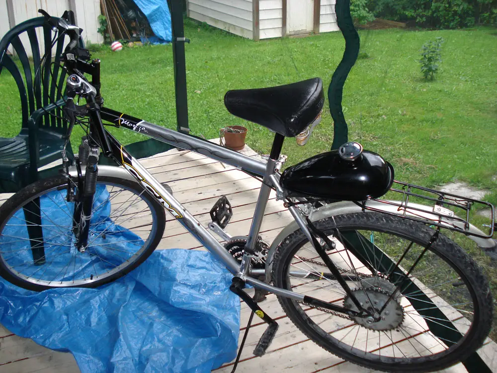

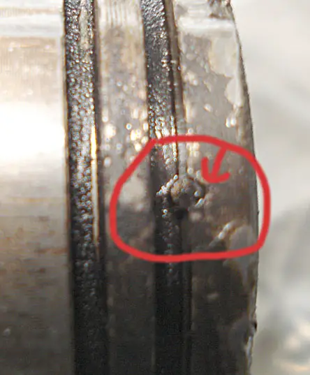

The wooden dowel worked like a charm thanks, I plan to update this post as I move along through my repair. This might eventually help another noob to the top end rebuild!

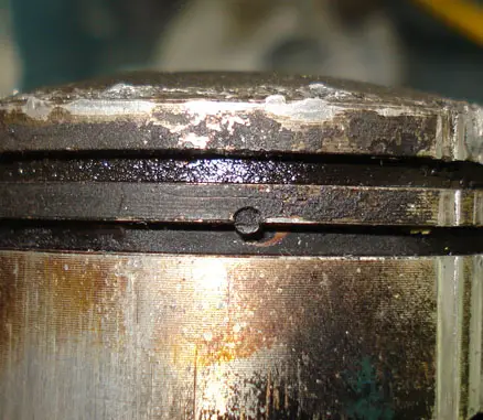

Pic 1: Here is a pic my bike looking very sad
Pic 2: how a dowel fits into the piston
Pic 3: I believe that is the Tit

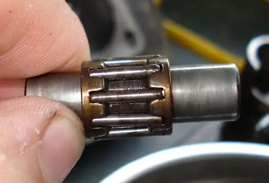

Pic 4: Roller bearing
Pic 5: Crank arm
Pic 6: Bottom tit
Pic 7: Crank case before cleaning

I was talking to a coworker about how my repair was going so far.
I told how the pin was hard to take out and that the roller bearing came out easily.
He was saying that when he had repaired his dirt bike that roller bearing was snug in the crank arm, is this the case with these engines?
Do I need an new roller bearing and wrist pin to?

Is There supposed to be a wrist pin bushing on the crank arm when i took the piston there was not one there.
Old 09-01-2009, 07:07 PM
MarcPhotoMan MarcPhotoMan is offline
Location: Montreal, Canada
Posts: 258
Default Re: I need some help with top end rebuild
The needle bearing and the bushing have the same part number, so my thinking is that They are interchangeable parts
