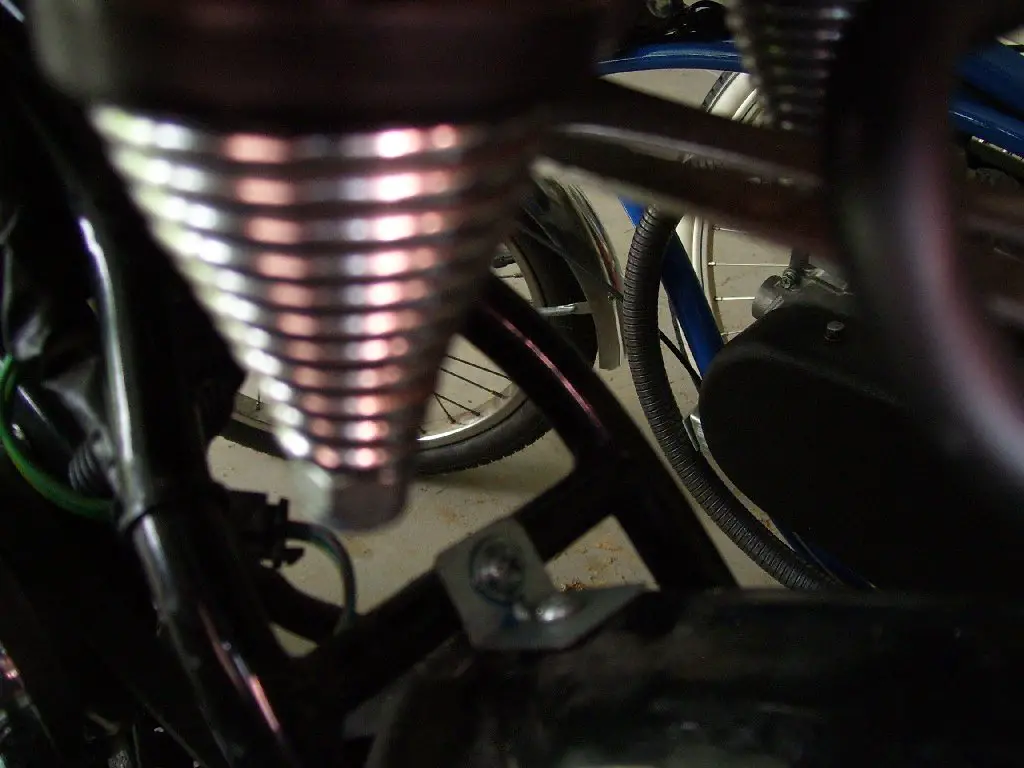

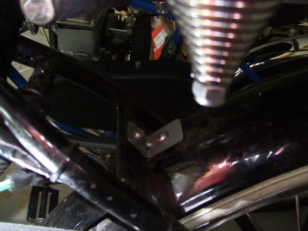

Well it finally happened. My back fender bracket under the seat broke. They all eventually do. Here's my fix. I removed the seat & bent a piece of tin & slid it under the fender so I wouldn't drill through the tire I'm known to do things like that). Drilled the hole & made a little bracket & bolted it on. Nothing fancy, but it works.
Jay

I did that too and it broke, tried plastic and it broke too. Used a small eye bolt this time and it seems to be holding up very well.
