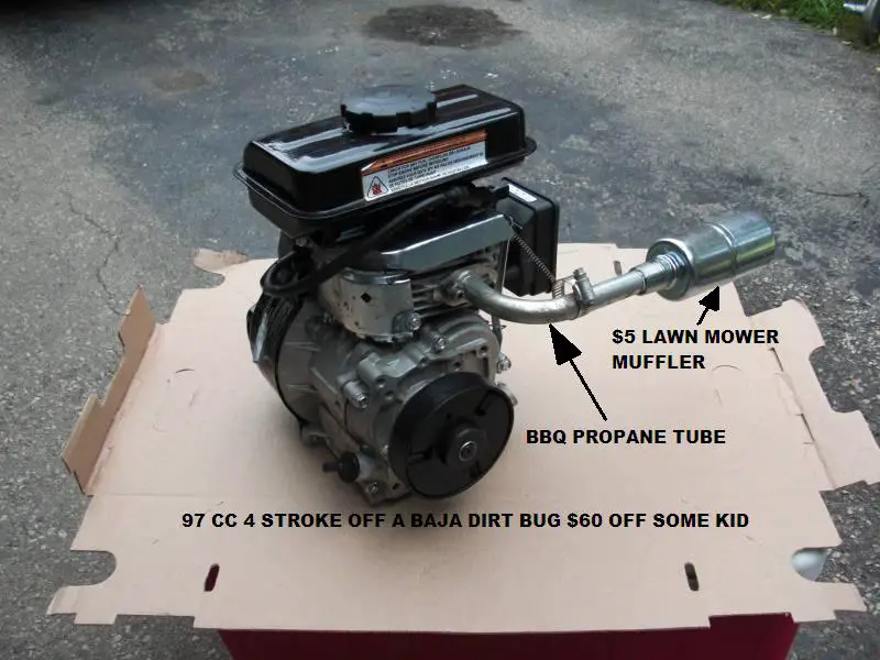

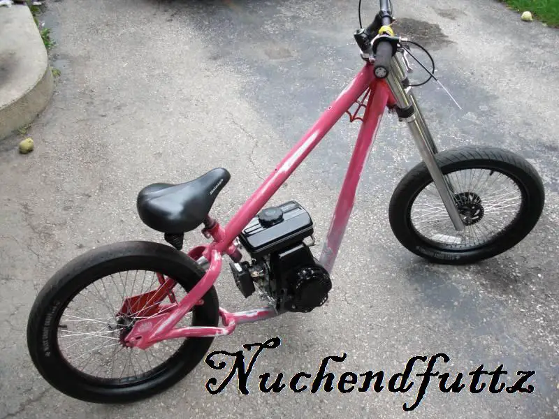

Hi there . Thought i,de start a post in the DIY section where the real builders are . No bolt on kits here .

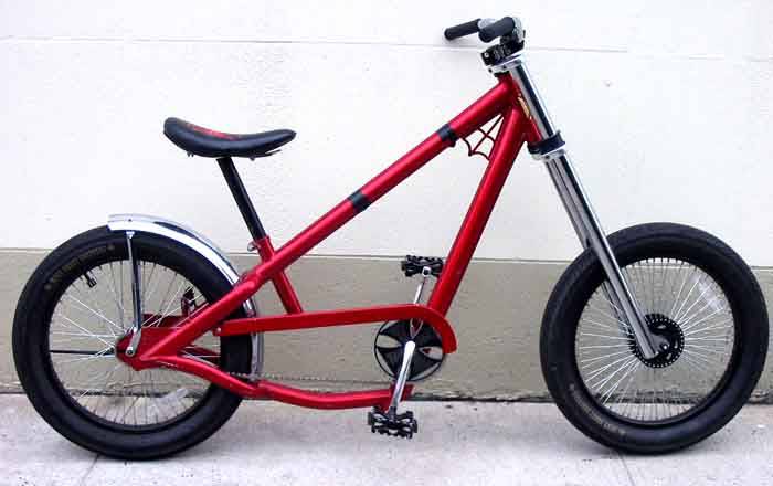

This is my project ( Nuchendfuttz ) . i,m starting out with a Jesse James WCC bicycle , that i found at the salvation army store for $25 bucks

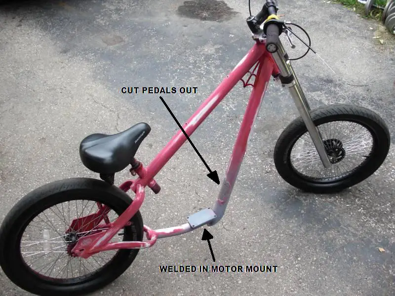

I cut out the pedals and welded in a mounting plate for a 97cc 4 stroke off a baja dirt bug .
i have a temporary kickstand on the back wheel , I plan to make a kickstand out of a 10 speed front fork tube , and some foot rests out of a low rise mountian bike handle bar . I still need to make a jackshaft . I don,t really care if it goes real fast ( top speed ) so I,m gonna gear it low , so it takes off quick .
I keep getting new ideas so my plan aint set yet . but i,ll update my progress .

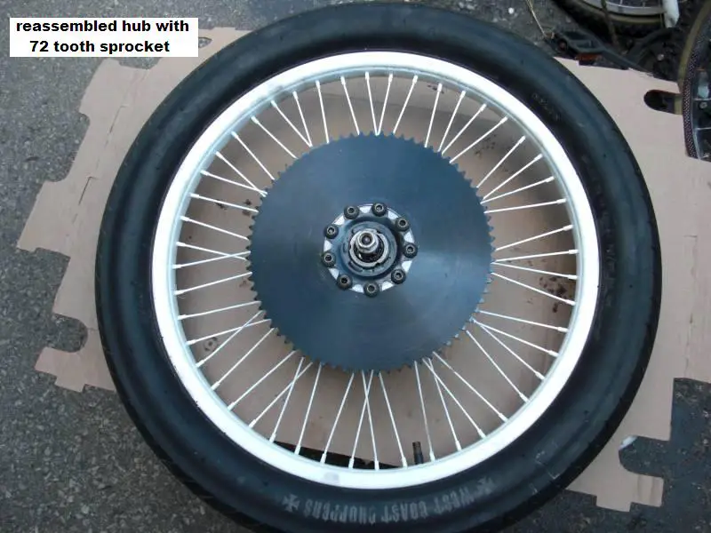

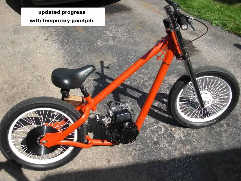

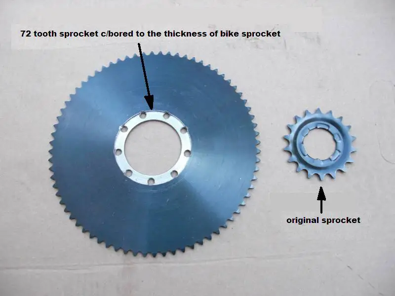

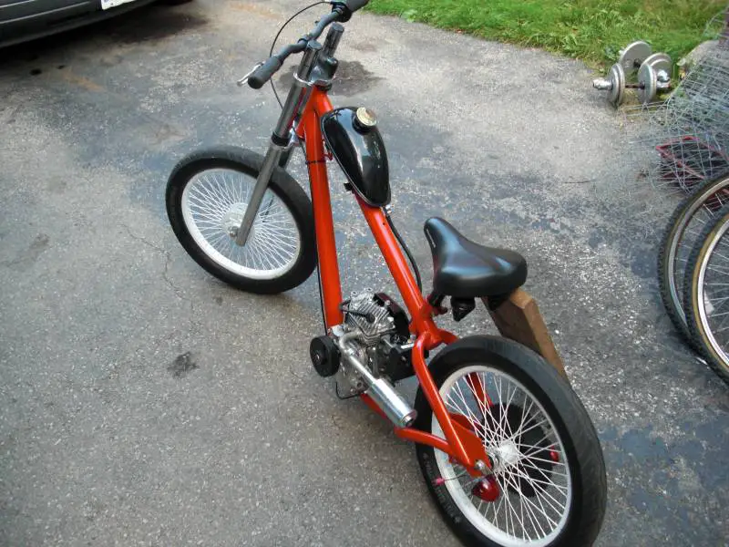

Here is some updated progress
I added a 72 tooth sprocket to the rear right sprocket
( hub still functions as the original coaster brake did )
paint is temporary so i don,t have to look at the ugly sanded down finish
when i get the chance , weight reduction holes will be added to the rear sprocket
I,m still working on the jackshaft and trying to come up with a cool idea for a tank

ok . i just contradicted myself .
told someone else i wasn,t crazy about the china gas tanks .
and i just put one on
looks better than the engine topper gas tank anyways

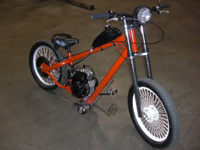

yeah , it has a centrifical clutch . you can see it there in the last picture .
i,m still working on the jackshaft , and a kickstand i,m making out of a 10 speed front fork .
once the bike is done , i,m gonna start working on a sidecar for it .
when its done , it won,t be very fast because i intent to gear it for torque , not speed .
its gonne have to be able to go with 2 adults on it , and its only a 2.8hp motor .
fortunately there is enough room in the frame to go to a 5hp motor if i need to .

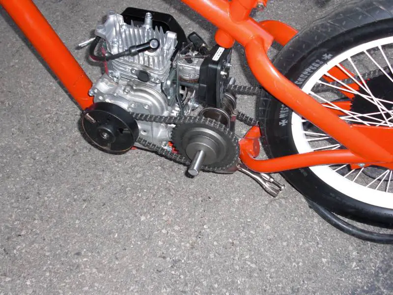

update
i made a bit of progress on the jackshaft , i had to raise my motor 1 inch so the 2nd chain would clear the rear tube . now its ready for welding .
i had a temporary setup before , i think its gonna do wheelies

got the jackshaft welded in now , gave it a test spin up the street .
slower takeoff than i expected but at the same time faster than i expected .
( 12t - 40t engine to shaft 3.333-1 )
then
( 15t - 72t shaft to wheel 4.8-1 )
= 16-1 ratio
1836.72 mm circumferance on the rear wheel
1836.72 mm/1000,000=.00183672 k/rev
estimate 4000 rpm top speed x60= 240000revs/hour/16 =15000revs/h rear wheel
15000x.00183672=27.5508
estimate 27.5 km/h ??? seemed like i was going much faster than that
thats about 17mph . its faster than walking
but slow enough to hear the little kids go , AAHHH COOOOOOOOOOL !!!!
