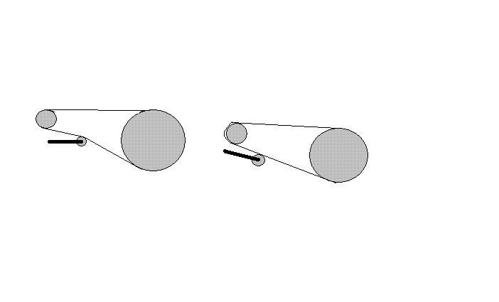

Forgive my ignorance, but what is a "belt slip clutch"? What does it do exactly? How does the bike act like?

the idler pully tightens and loosens the belt when the belt is loose it slips
on the small engine pulley

Thank you. That makes sense.
