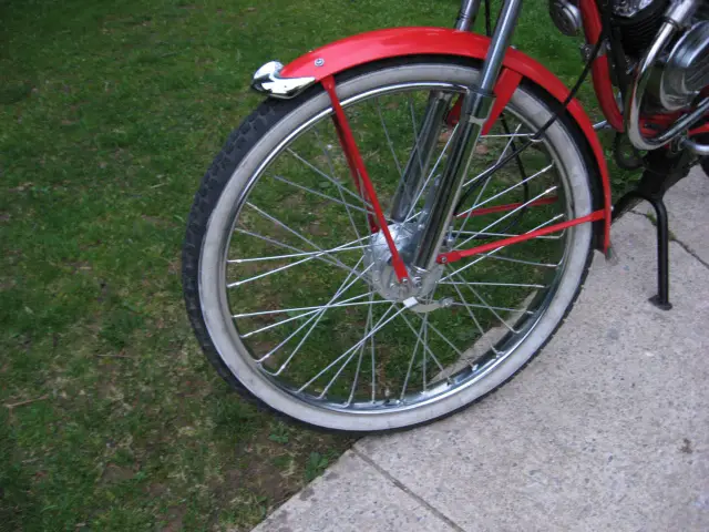

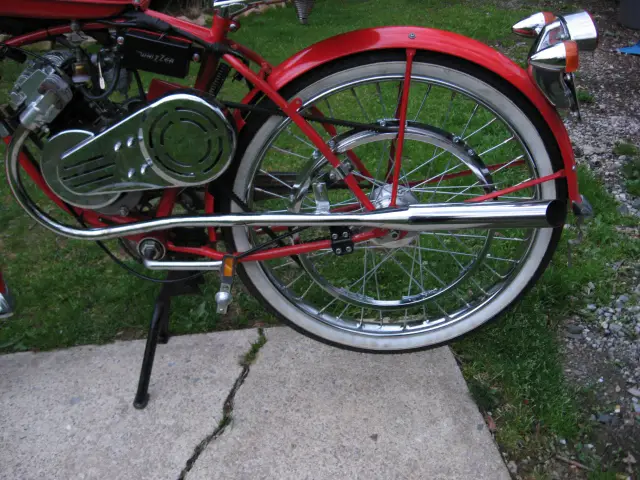

Here are a couple pictures of my Worksman Wheels installed on my Whizzer.
Jim
PS The drum brakes will throw you over the handlebars if your not careful.
ID:	12343   Click image for larger version
