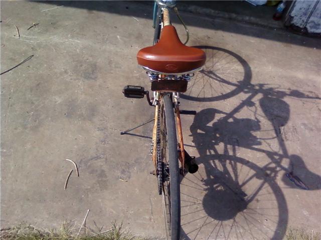

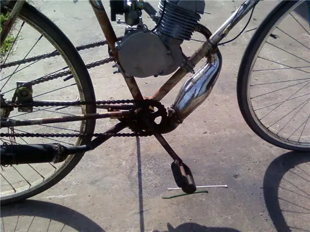

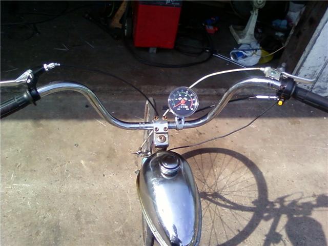

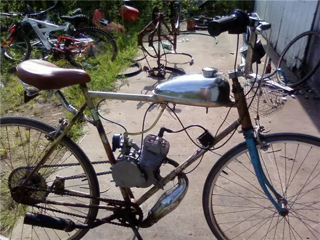

It's real ugly but i wanted to get everything done the way i wanted iot before paint and dress up but now I think I'll start over i used a red bat 70 cc from boy go fast custom expansion chamber left over from another build its got a wally world bell springer seat a bmx head stem so that handle bars are easier to switch out and motorcycle handle bars cut down about 4 inches on each side right now its running 1 3/8 X 26 tires i figured they would have a lot less resistance but the ride quality is horrible on rough terrain and loose sand you can forget about all control i used a 18 speed moutain bike sprocket the smallest on the crank to pedal with so that it is incredibly easy to pedal. it had a direct drive speedometer but it toasted first run any way its a work in progress i cut the head tube down this morning and added a mountain bike front fort with telescoping suspension and wide knobby tire seem to work pretty good I'll put pics of that later any questions or comments? I can take it, this wasn't a make it nice effort just comfortable and make it work good.
