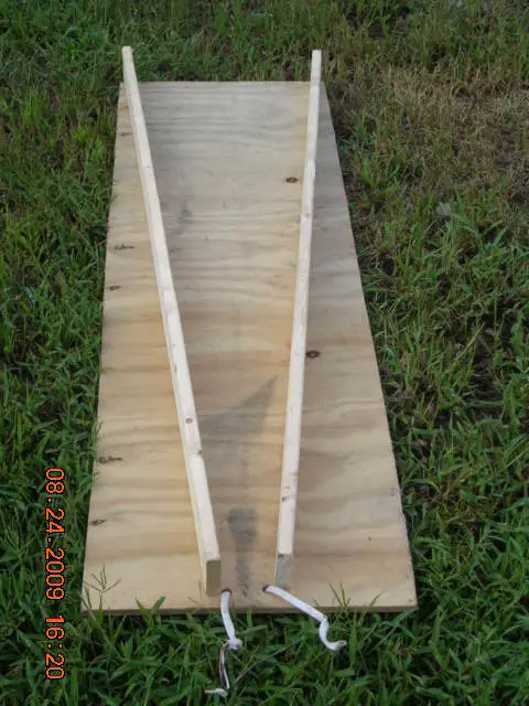

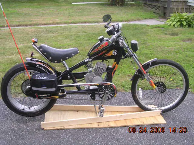

I find this very useful when working on my occ. I can run the engine and check things out like chain slap and brake action. 2-1x3's a piece of 1/2 in. plywood and a few screws.
I use a piece of romex too tie the front wheel down, it does not blemish the rim and elevates the rear wheel.
