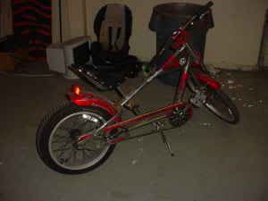

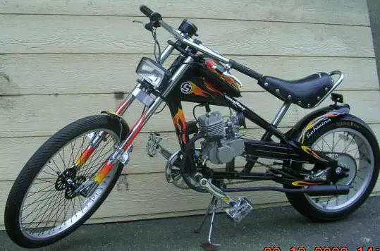

Do a search on OCC stingray. If you purchase on craigslist you can usuall find one for under $50.
The build is not as challanging as most would have you believe. However if you are mechanicaly challanged look up plug and play builds. Many 24 in bikes will accept motors.
The plywood behind the bike is 48 in. high, however guys up to 5-8 ride this model (usuall under power only).

You say the fit from seat to handlebars can be a bit much? The older green Moon Dog (mens cruiser) bikes are a shorter frame and have looong pullback bars.
Also, I have seen beach cruiser 20 and 24" bike with an engine kit mounted up, no problem, and easier than the Stingray type chopper bikes fo'sho'!
