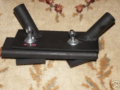

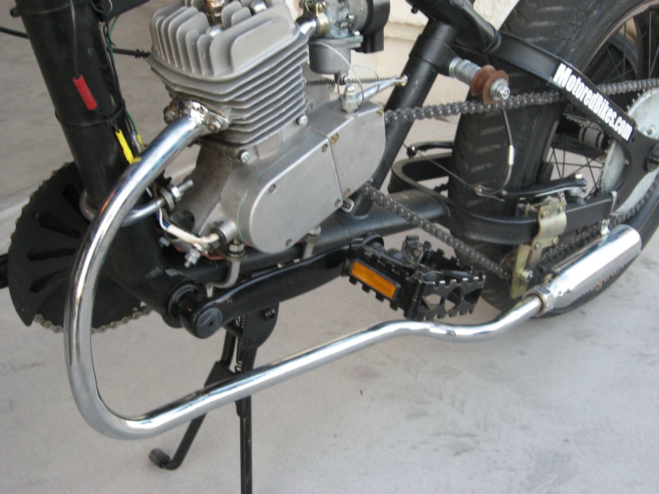

stingrayboy: l have used both motor mounts.#1, from livefast = its not very good, it will crush the frame tubing on the bike over time.#2, was from barry on ebay = this is the one u want! its strong and will never crack your frame.here are pics of both.
the engine l would recommend is a livefast engine, this is just my opinion, but you really should check out your local laws to see if you can ride a motor assisted bicycle. i think the age is 16 and up, but l could be wrong................later

how tight did you tighten those U bolts? Lots of people use them here and I haven't heard of anybody's frame getting messed up because of them....
