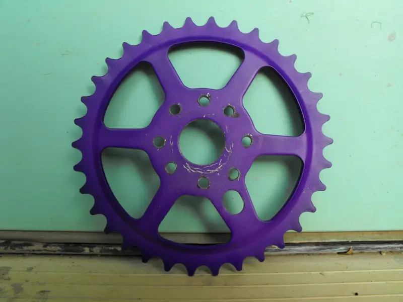

This sprocket is drilled for the 8 flange openings in the old style schwinn hub- some vary, and some have NO holes in the flange and would need to be drilled there too
And I should mention that the center hole here has not yet been drilled for the hub- there won't be much clearnce then between that and these bolt holes- but I think enough.
This sprocket from bikeparts4you on ebay- $11 delivered)
But beware!
a small flange flip/flop or other hub would still require the usual ruber and bolting to the spokes-
this sprocket would be difficult to attach in the usual way

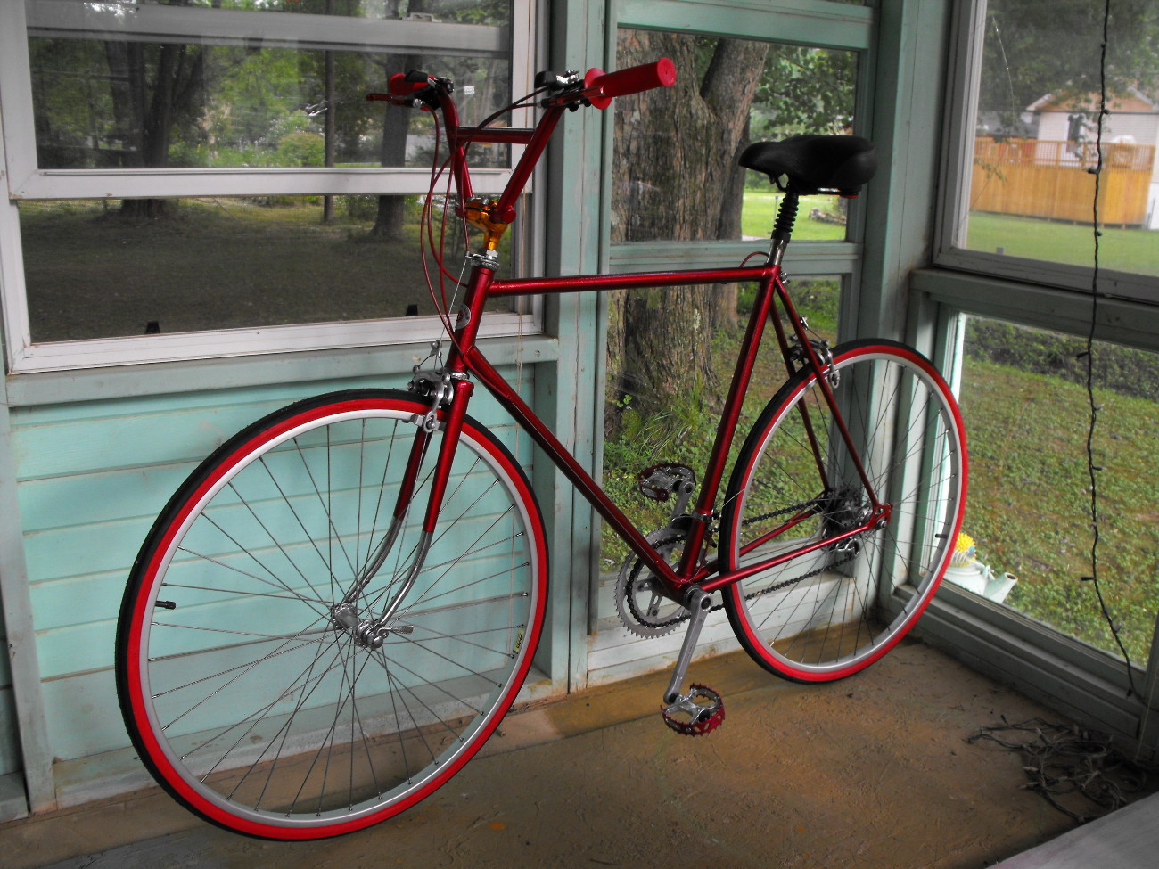

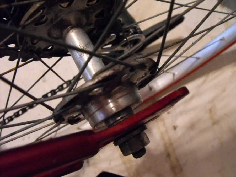

Here's the hub, and the bike
I ground the hub with just a flat file-
by turning the bike upside down and pedalling it, and holding the file halfway on the spinning hub-
INCREDIBLY EASY!
If and when I build this bike- I'll probably take off the derailleurs and use a single frewheel on the bike chain side. I've got a narrow chain and motor sprocket ready too- and with a light 49cc, I'm projecting a final weight of about 37-38 lbs, withg these 27 X 1 1/4 alloy rim wheels.
I just put a 27" inch narrow 1 1/4" wheel on the front of my cruiser, and a Campy brake too. With the 26" X1.75 rear wheel still on (I may change that too, but maybe not) she REALLY ROLLS- very easy, and pedalling is approaching normal- The brake is GREAT- much better than cantilever- I'll take some pix and post here.
