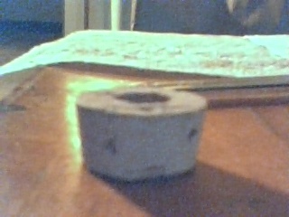

Just want to let you know that the cork I used for a float is holding up. After drilling center hole and cutting to the right thickness I coated it with seal-all and let dry. I been running nit for about a week and a half and then checked it. The bike runs fine and the cork float is still dry. Thanks

It's still working nice ! Thanks
