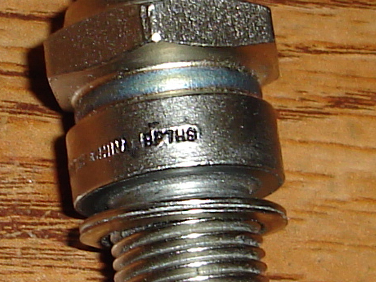

I've attached a picture of the stock Chinese plug that came with my engine. The picture shows a clear cross reference to a NGK BP7HS. I really learned a lot about spark plug companies while making the list. I haven't heard of some of them until now.
DISCLAIMER: Not responsible for any damages. Double check my info before buying and make sure that the new plug matches up with the stock plug that came with your engine unless you're using "shorty" plugs. Have fun and ride safe.
