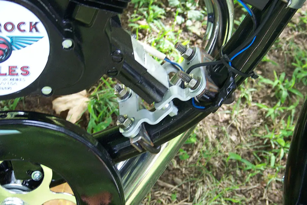

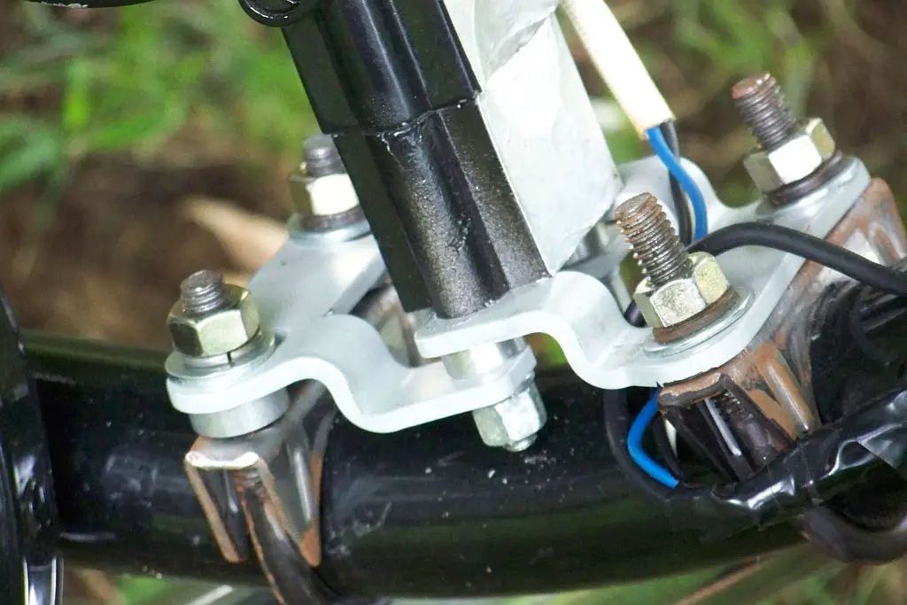

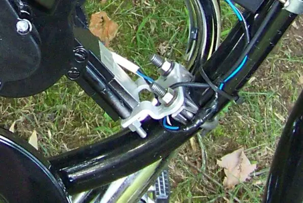

I ordered this mount from SBP because I had a couple big tube projects (Schwinn Riversides).Once I mounted the first one I realized right then that it would not last very long. I decided to remove the
mount and start working a solution for this crazy down tube. While working on another project a light came on and while I realized it would end up being an expensive venture I went ahead with the project as you can see double the strength,double cost.Needless to sat I'm working om my own solution...RatOn!,RatSafe!...Cheech
