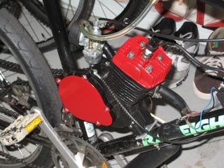

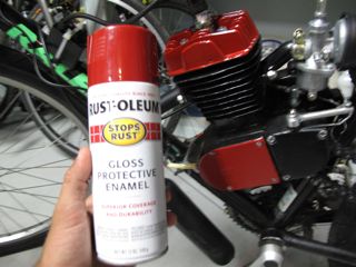

I have seen lots of bike paint-jobs, but I want to see what people have come up with in terms of engine painting. Please post pictures, advice, experiences or your thoughts on the subject.
I decided to experiment using Rustoleum gloss protective enamel. So far it is holding up. I will update after I put some serious miles on it.

Depends on how hot your motor gets. But the rustoleum may get to hot.
I was actually expecting the rustoleum to be a failure(melting off as soon as the engine heated up all the way), but I was riding all day today and yesterday, running the engine hard(and very, very hot) and so far it has held up perfectly. Only a true test of time will tell... If it starts to come off I will be sure to let you guys know.
