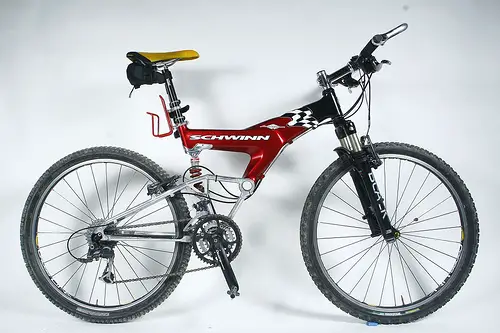

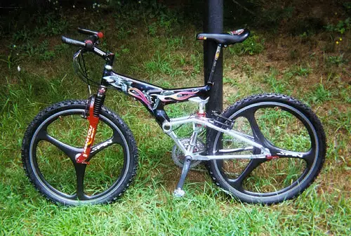

i know this is not a motorized bicycle but wanted to post the before and after pictures of what a custom paint job can do. it was a sharp looking bike before it was painted but the paint job made it look like no other. the dragon the flames and everything else was done with an airbrush
