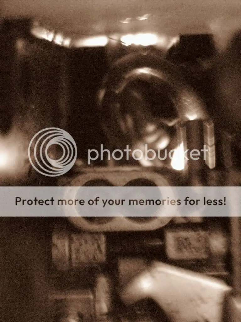

i have a craftsman 32cc weed eater, on my bike... when i ride (clutchless, pedal start) it idles, then
dies. it will die instantly if i give it gas. im a newb but i believe it is the needles
IF not let me know
if it is please tell me ... WHERE ARE THEY!??
i looked on the carb, and i see two screws, next to each other, but i don't know if that's them or not.
if it is which is high or low??
the screws are located in what looks like an electrical port.
this is what i think is them

do have any other pics? this looks like an ultrasound to me

the high side is usually on the left and the low on right. turn in the left (high) all the way and then back out a couple turns and then turn in the right(low) and back out about 4 turns . that ought to get it going then have to do some tweaking once it's running. the high side should be adjusted after running in a wide open throttle to get the most out of it and then and then the low side for idle to keep it running without dying.

sorry about the quality... had to be close to get to show you what i mean. i dont know very much, kinda new and my nieghbor helped me a lot.i will giv them a turn tho

my nieghbor thought it was just one screw.
