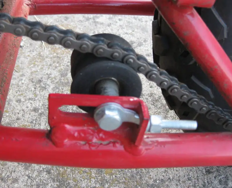

For those who can weld or willing to hire it done, here's a great tensioner idea that's very simple.
Name:	Doodle Bug chain tensioner.jpg
