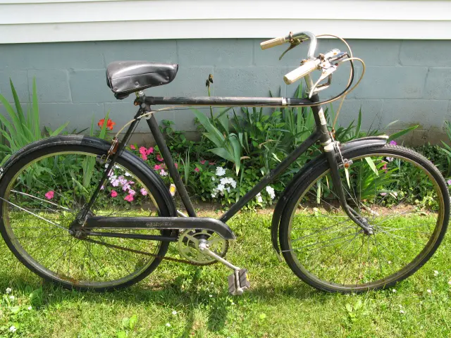

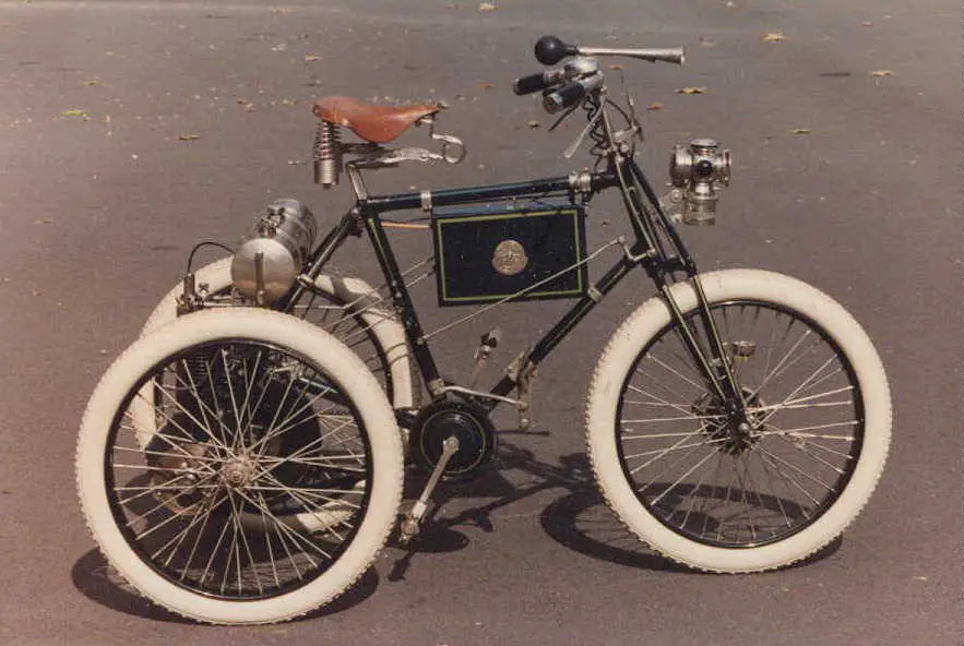

i only want to mount it there because the one i am reproducing had it there. here is a pic of the bike and what i have to start with. the royal scot i have to start with looks like a good frame to mount a motor. it also looks to be able to handle a trike rear end.
since its my first any comments or suggestions would be helpful.

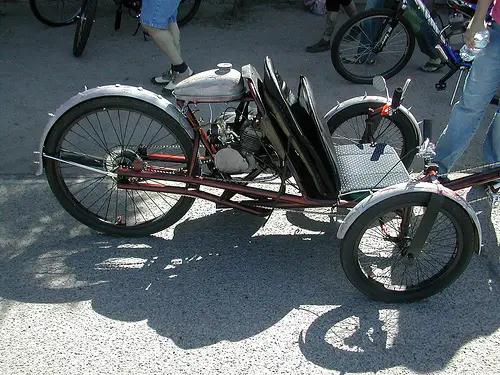

if you could rig a low, rack-type mount in the back, I don't see why Spooky's set-up wont work
I have built a trike using his whole arraingment...it should work
the trike rear will extend the back (bolts to orig drop-outs), so, a mount up tight to your seat-stays will work
as an example...check out how George from tuscon's trike is mounted
thats what i was thinking about. there is room to mount the motor mounts on the trike frame. there are two horizontal bars unused. is there any reason why you cant run the chain vertically.
