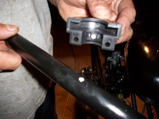

I use paper white-out and mark the pin, then set the throttle housing on the bars and the white out will mark where to drill.
