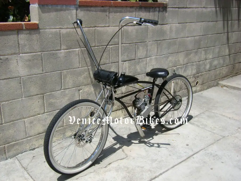

I've done a few things to the 55 straight bar Lowrider...
I added a front disc brake, I removed the chain tensioner & I added a leather tool bag.
These things really spruced up it's look!! The front disc brake works sooo good!

That looks really good nice and clean

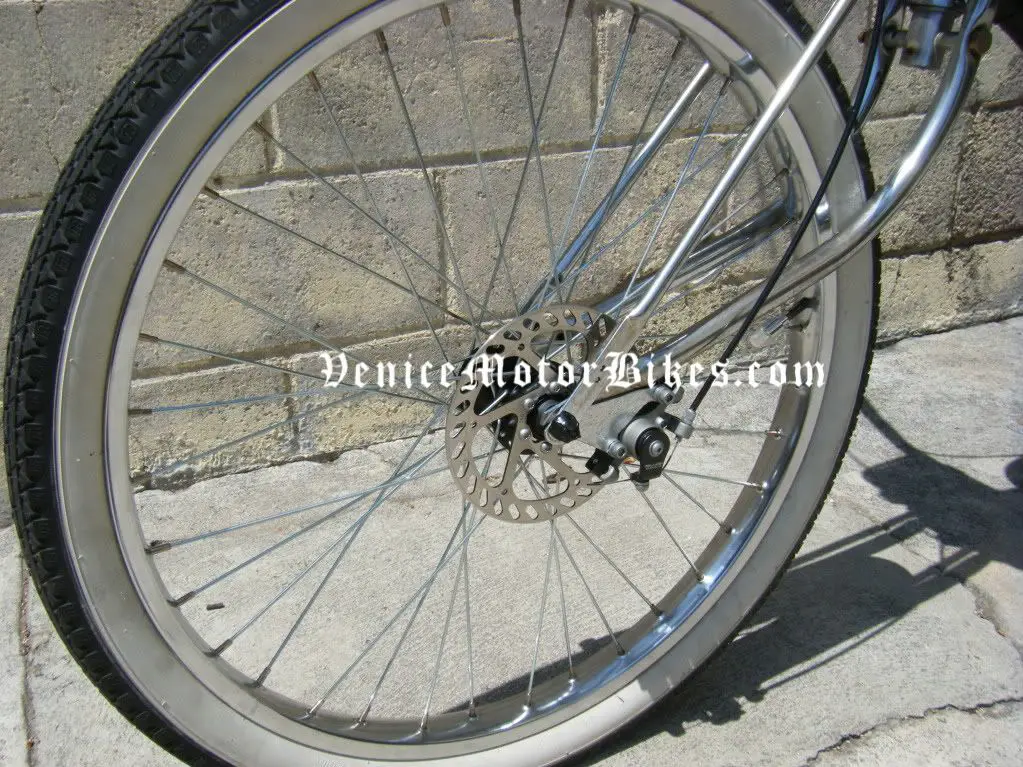

Is the disc caliper anchored to the fork with a strap or did you weld a tab ??
I'd also like to know how those bent forks handle ... TIA

The caliper is mounted with a flat plate off the axle... It works very good, but I can't roll the bike backwards with the brake on or it will spin backward... I'm making a new one that will anchor to the fork better.
Also, the lowrider fork looks really cool, but handles like s**t! It's very stable while going straight, but it doesn't turn very well.
This bike gets tons of attention & it's nice to cruise around on, but I wouldn't race anyone around corners on it!
