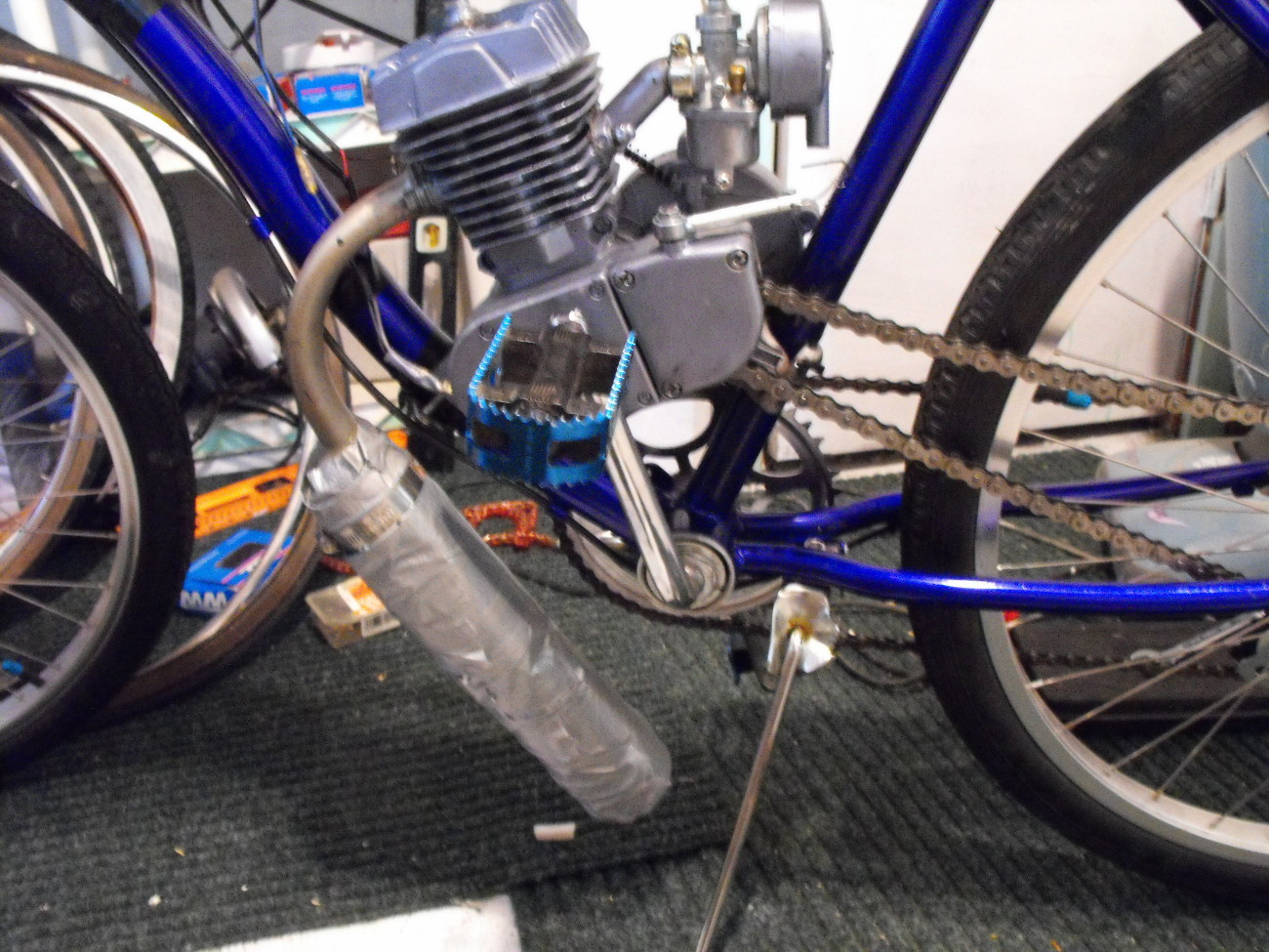

They were bugging me to post photos on my thread about putting two 16 ounce beer cans around the pipe and extending it.
here's a pic, before I rode tonight and the bottom one came loose because it's only taped and I have to get another radiator clamp for it-
The duct tape was smoking quite a bit so I'm not sure how well that will work out- It probably adds a little quiet, but I'm sure not as much as the cans themselves-
the only question- does it hold too much heat on the pipe?- a great heat shield otherwise and I suppose holes could be drilled in the cans- but then less muffled-
If the duct tape burns off, then you'll have to just have to beer can lables showing- chose your poison!
By the way, I painted both the motor and pipe with auto store touch up paint when I got my kit- (and a clearcoat)
The pipe burned and peeled quickly, but the motor's always been fine- and looks nice in pale metallic blue- I guess it's like the black kits.
how about some annodized paint? That might look good...

You have a great idea there, one I just might do myself - but your simply using the wrong product lol
Exhaust/manifold wraps are somewhat common on performance racing vehicles under the idea that keeping the exhaust gas temp as high as possible increases velocity and thus performance. A secondary benefit would be to keep the radiated heat levels down - in this case, away from your shins For us, it should work quit well to quiet the noise a bit, I remember it took some of the "bang" out of the noise from my headers on my old truck.
For $10 it cant be beat, remember to look for motorcycle wrap as automotive may be too wide.
It's available in a variety of colors, some variants are self-adhesive (but I would use fasteners anyway)
Also remember the old equation; trapped water+metal=rust, but with the low replacement costs for these exhaust systems - I don't think that's a problem.
Hey - thanks for the idea man, I hadn't thought of this, but I'll prolly skip the can extensions
