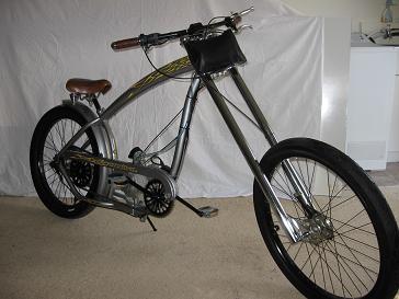

95% finished, just doing some final touches on the gas tank (i don't like the look of the kit tanks supplied) lovin this ride though, can't wait for the break in period to end!

really nice man, cant even tell its motorized. i like how the engine sits low.

Hey man that bike is tight. As for gas tank options....do you have a welder? That would be sick with a Diamond plate aluminium tank, I'm in the process of making one right now.

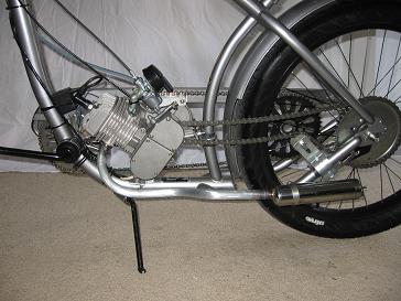

barebones, looks great! BUT,,, not to be a buzz kill, you may run into some carb problems due to the angle of your motor. Your motor needs to be mounted so the carb is level for the proper float bowl / jet function, but your mount may work fine. I will look forward to your updates.

^^^^ yea hes right. ^^^^ i never even noticed it until he mentioned it you are going to have to level that out for sure, or risk fuel starvation problems.

cheers guys, i'll have a look at it, explains why its abit jumpy at low revs.
