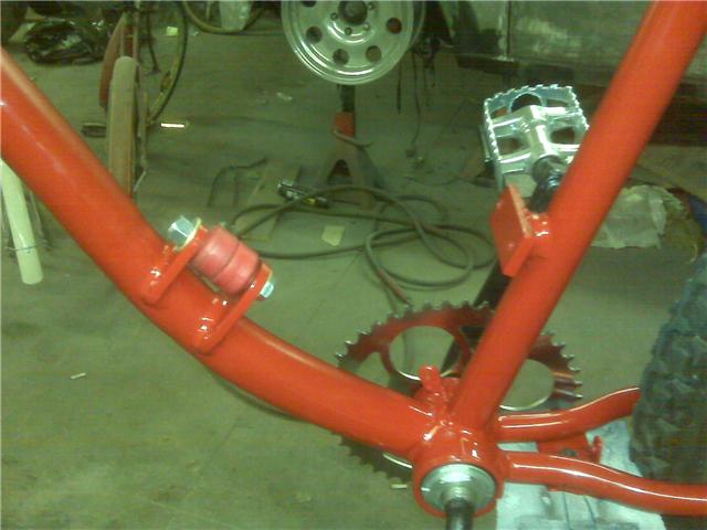

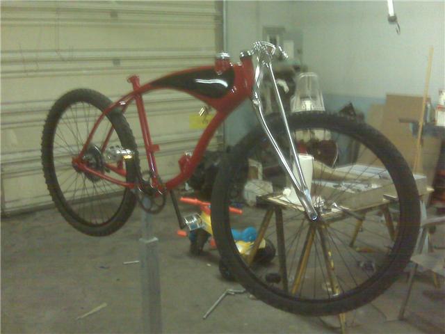

heres pics of how i make the mounts on the cranebrook and other large tube frames. i just cut out brackets and weld them to the frame. then use tierod end link rubbers from autozone. works great.

nice ride your building there cam lifter!

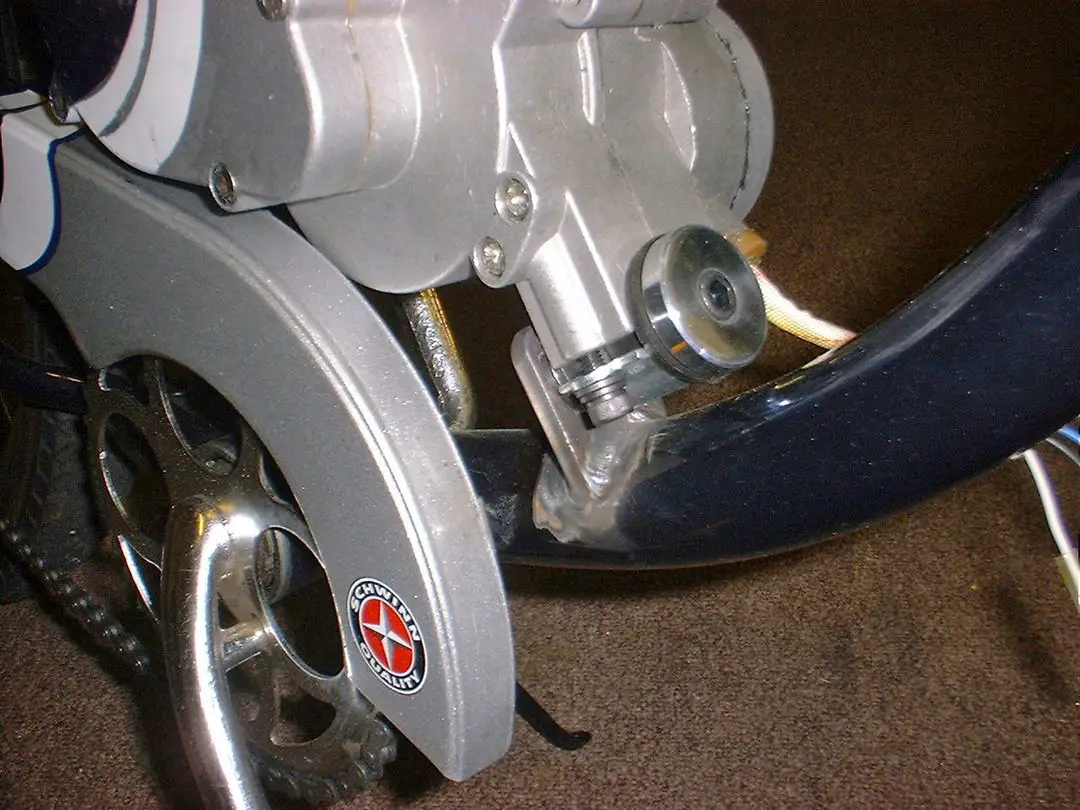

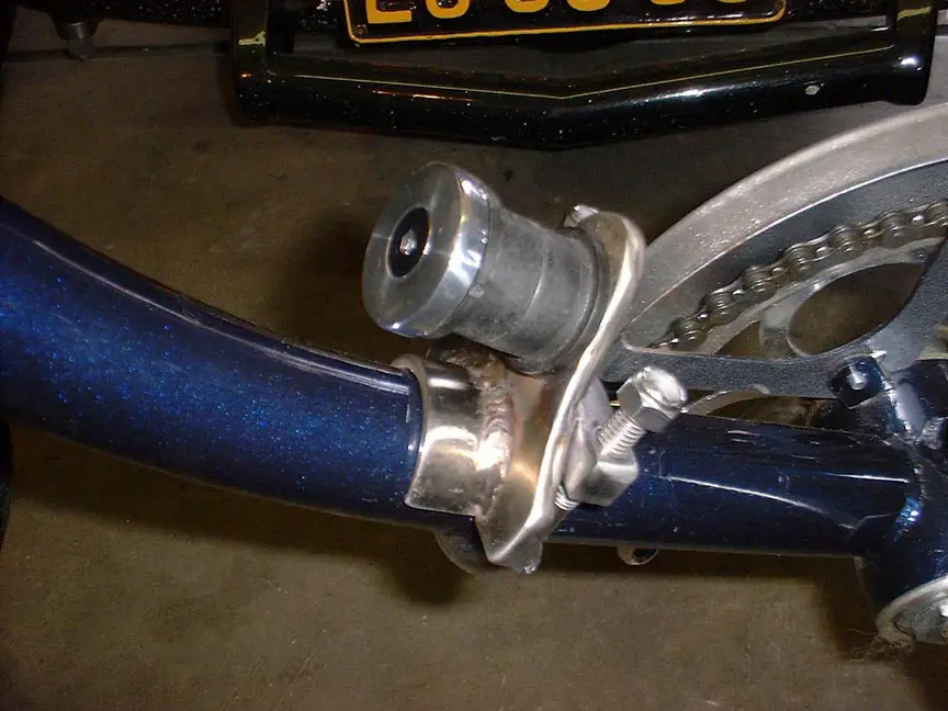

Here's two mounts, same concept but one is welded on, the other one clamps to the frame.
The difference between Camlifter's and mine is his is a double shear design and mine are single shear. Both will support a little 2 stroke just fine. Nice work, Cam.
