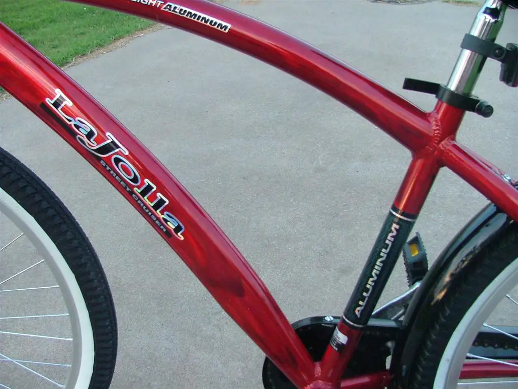

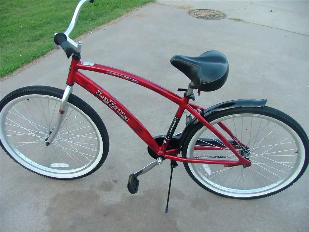

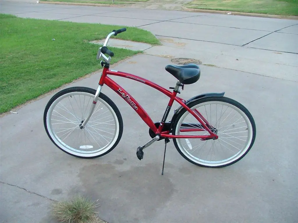

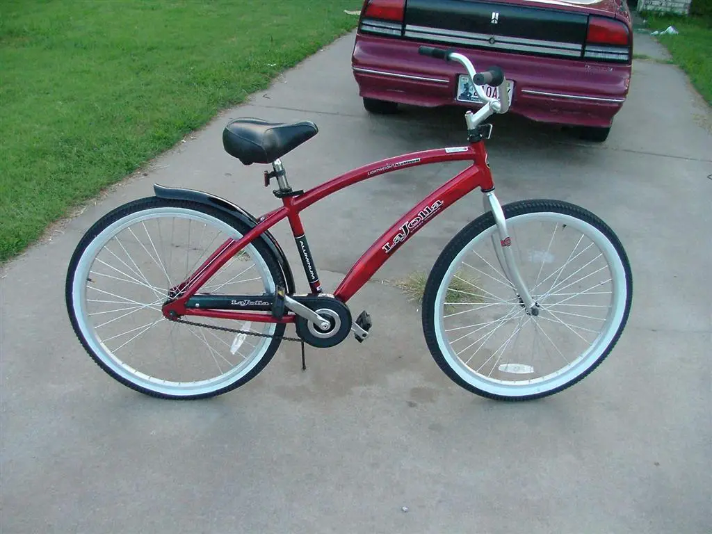

Thanks for replying and thank you for the welcome! I did do some measuring and I do fit within the tolerances. Barely but I do have the right clearances, but It does look a little small because of the lower bar, but if I do need to cut and/or weld I can do that without a problem. I just wanted to be able to fit up without many modifications to the frame it's self. Either way here are some pictures of the bike. It does have right at 11.5 inches from top to the crank if that helps. I have a 6.5 inch clearance between the crank arms. So any other feed back, on if the bike is any good, if anyone has motorized it yet or anything at all. I'm new to this so any feed back will help alot!

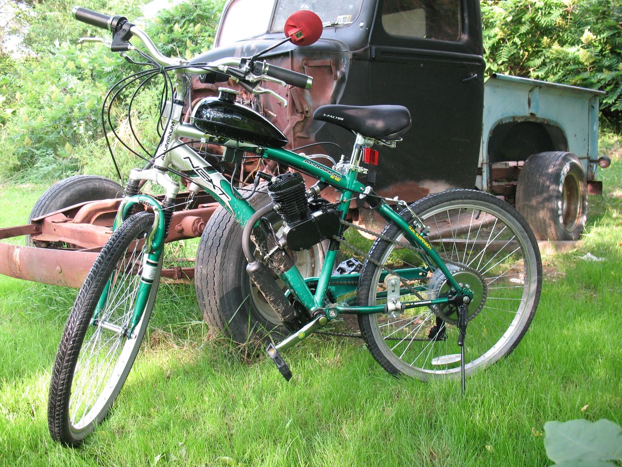

Well, Good Luck if you attempt it.
I wouldn't even try it at all without a slant head...
plan on a custom intake. and you will need to grind the front of the motor down a bit..(I didn't take any pictures of that sadly..) if you don't grind it.. you will have broken engine studs. as the engine wants to go side to side too much.
at least you don't have the rear spring/mess...
also, my muffler is slowly grinding a hole in my frame..
Fun stuff these "Next" bikes...
I'd recommend a slant head from zoom bicycles.. the kit comes with the longer studs for the front..
(the 15+ day shipping is no fun though.)
