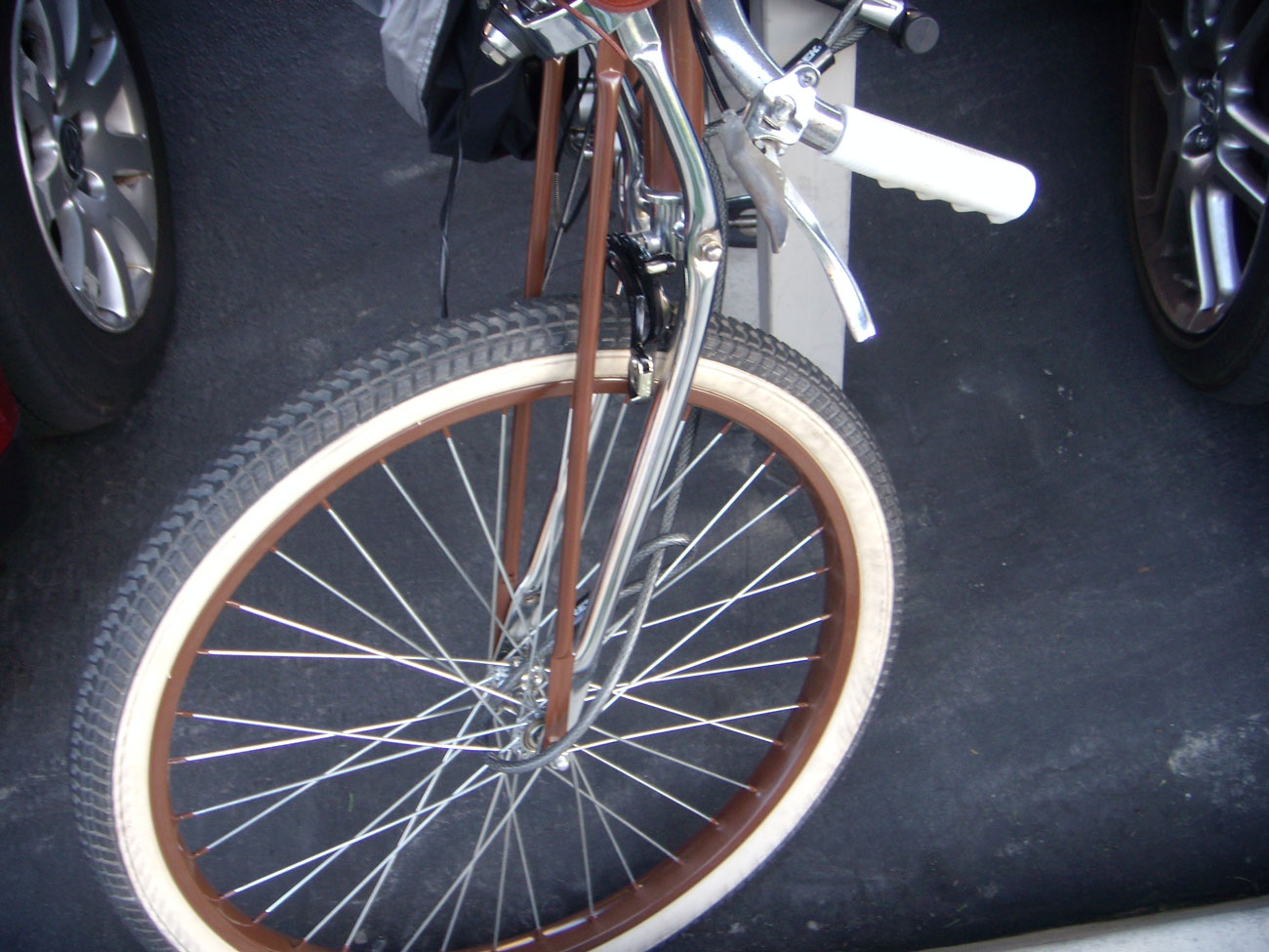

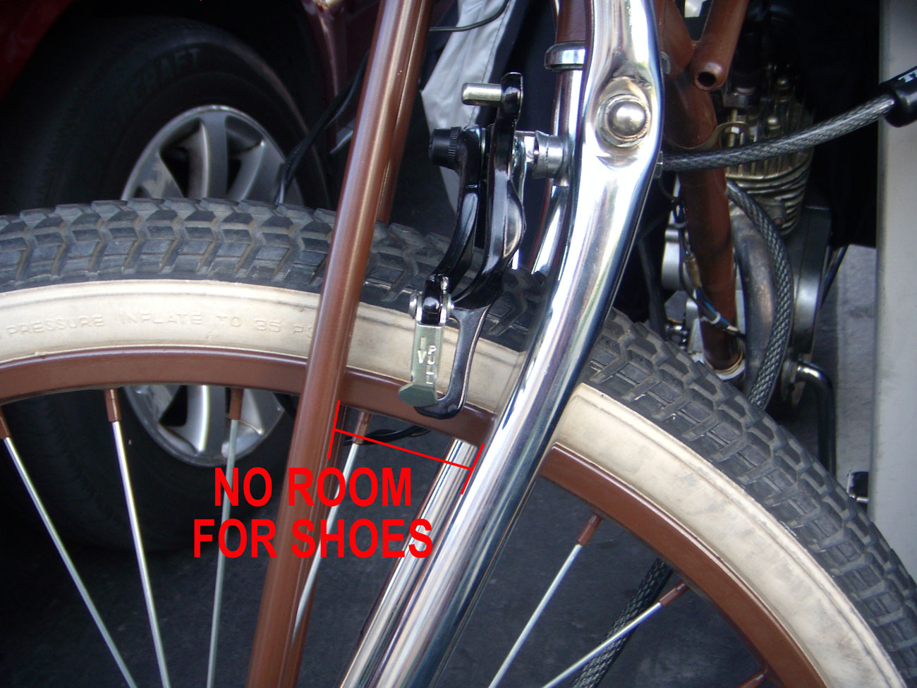

All I have right now is a rear coaster brake and I want to add something on the front. I first ran into problems with finding a place on the handle bars for the additional lever. (I saw the dual-pull ones in another thread but I don't want the clutch and brake to operate together.) Is there another form of dual-lever that mounts as one but pulls separately? (two levers, one mount)

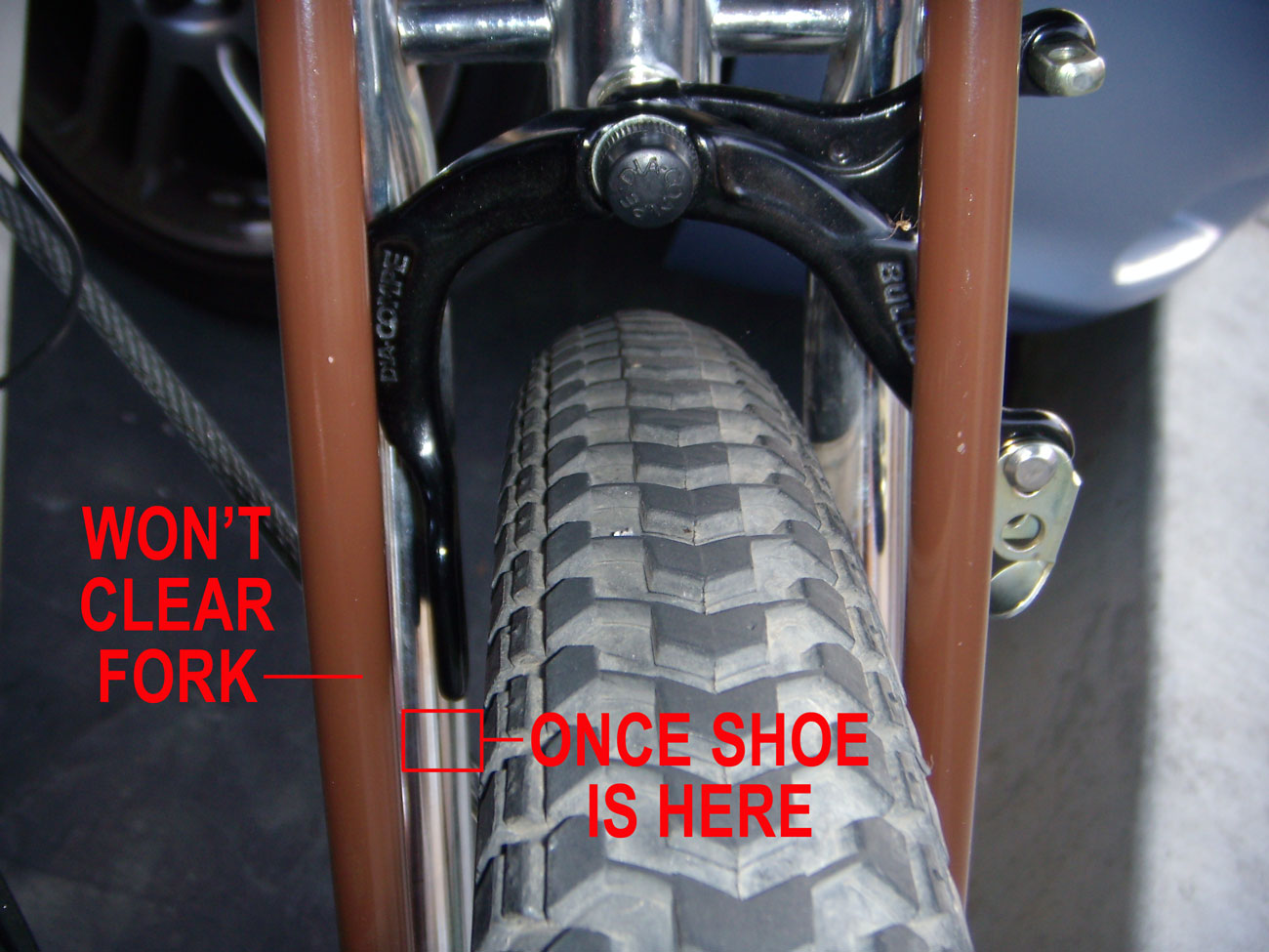

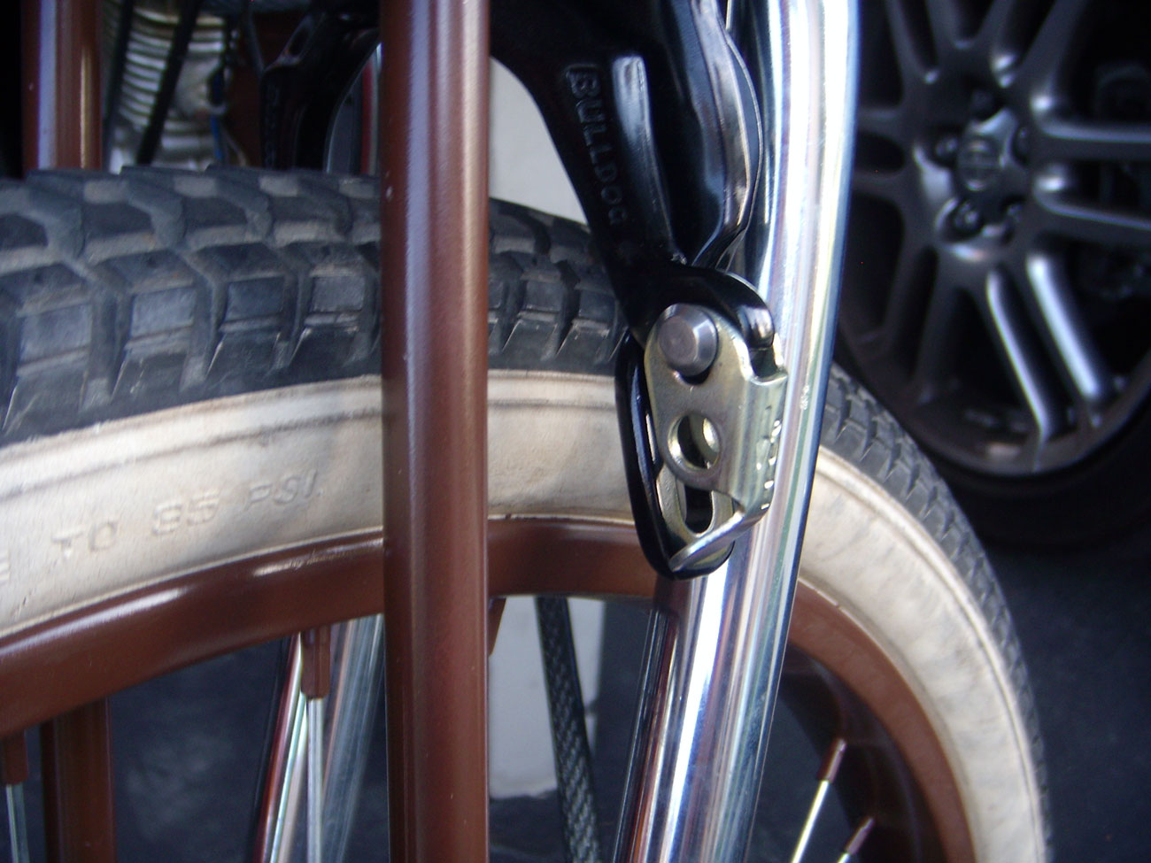

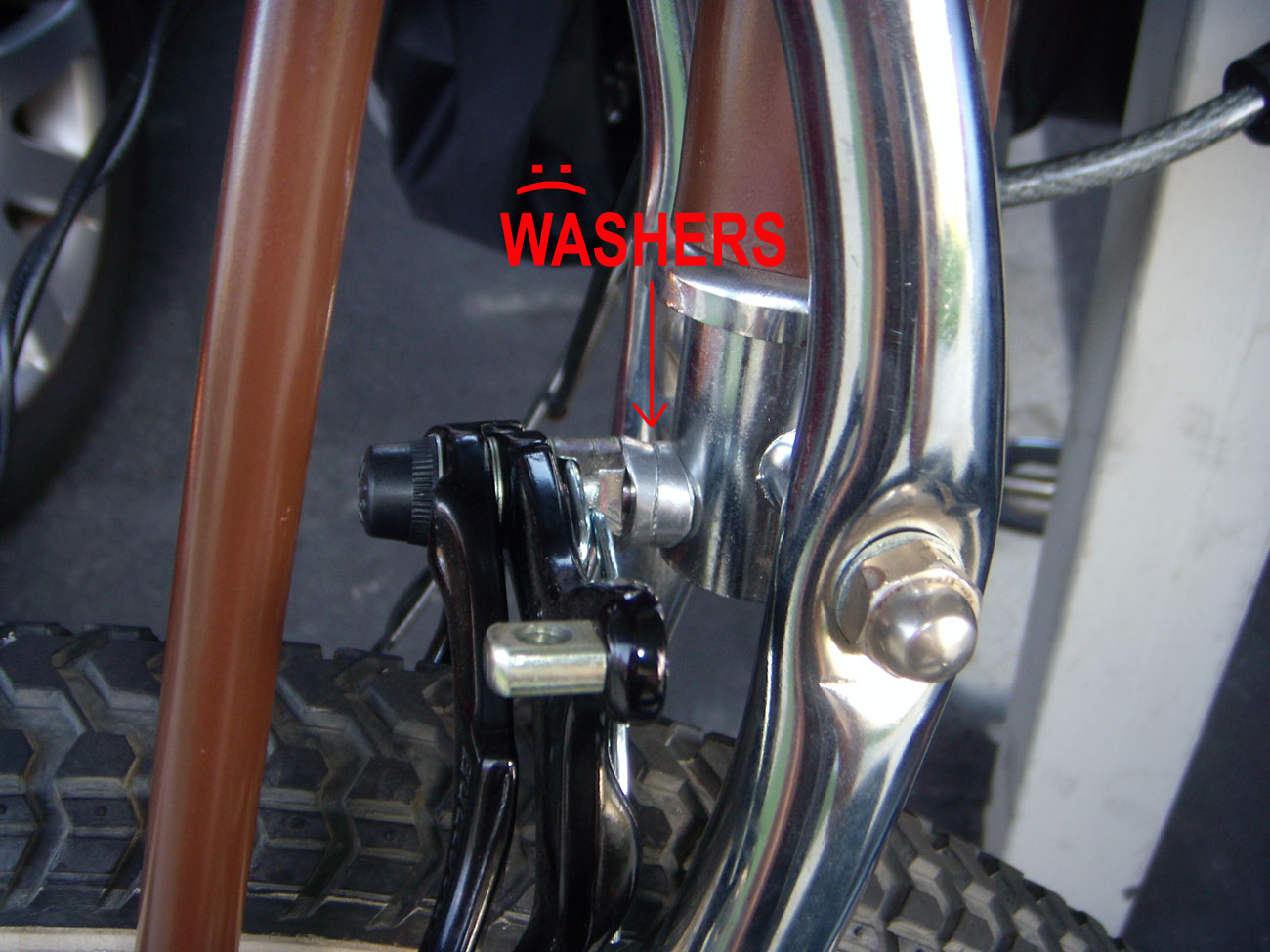

My next issue was mounting the caliper brake system. The stem already had the center hole so I assumed there'd be no fit problems. Due to the nature of my fork, I had to space the brakes really far forward with a bunch of washers (which I am not at all happy with). Also, there isn't a lot of room between the fork and rim for the shoes to have full clearance or even the calipers to open fully. And I'm thinking as soon as I brake the first time, all the paint on the rim will come off.
Maybe a disk brake is a better solution? Will that work on this hub/frame setup?

When you squeeze the brake caliper together are the tabs long enough to make contact with the wheel? From the pictures it looks as if those brake arms are too short. Once you squeeze the calipers together the pads should clear the forks, they will be just to the inside. You may need to get pads that have a shallow profile. I've found that BMX brakes are plenty long enough to mate up with the wheel.Brakes - Pyramid MX Brake Set bike brake set bicycle brake set front brake rear brake | BikeWorldUSA | Bicycle Parts and Bike Accessories.

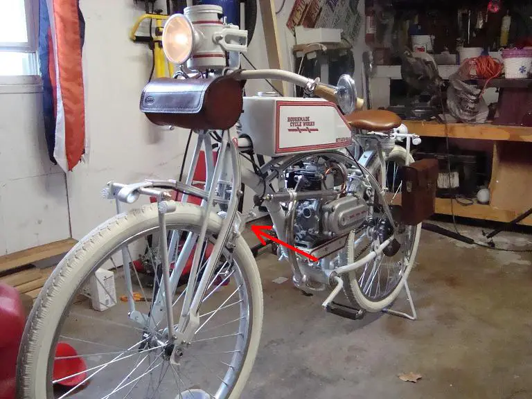

All I can say is that a caliper works fine on the back of the fork...not that anyone will copy my mount.

Even if I cut the pads down lengthwise there still wouldn't be enough space between the fork and the rim for the caliper to open all the way with any shoe on there. I think I would have to shave at least half the thickness off as well. Factor this in with the mounting issue and I figure there has to be a better option (though I might end up doing this).
Already tried mounting on the back of the fork, the angle is totally off and nothing reaches/lines up. I need something like HoughMade's, awesome!!!

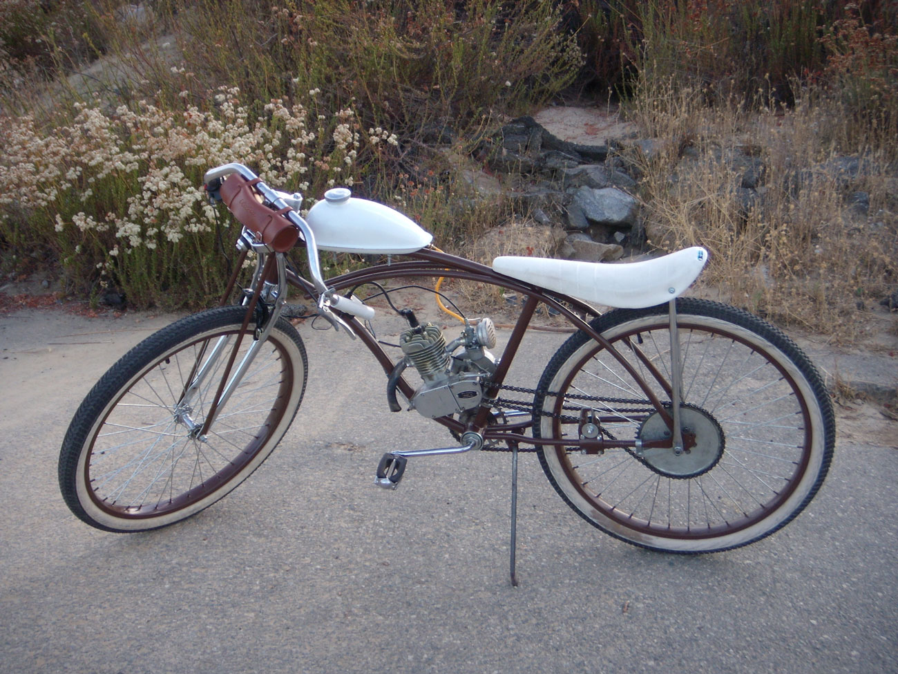

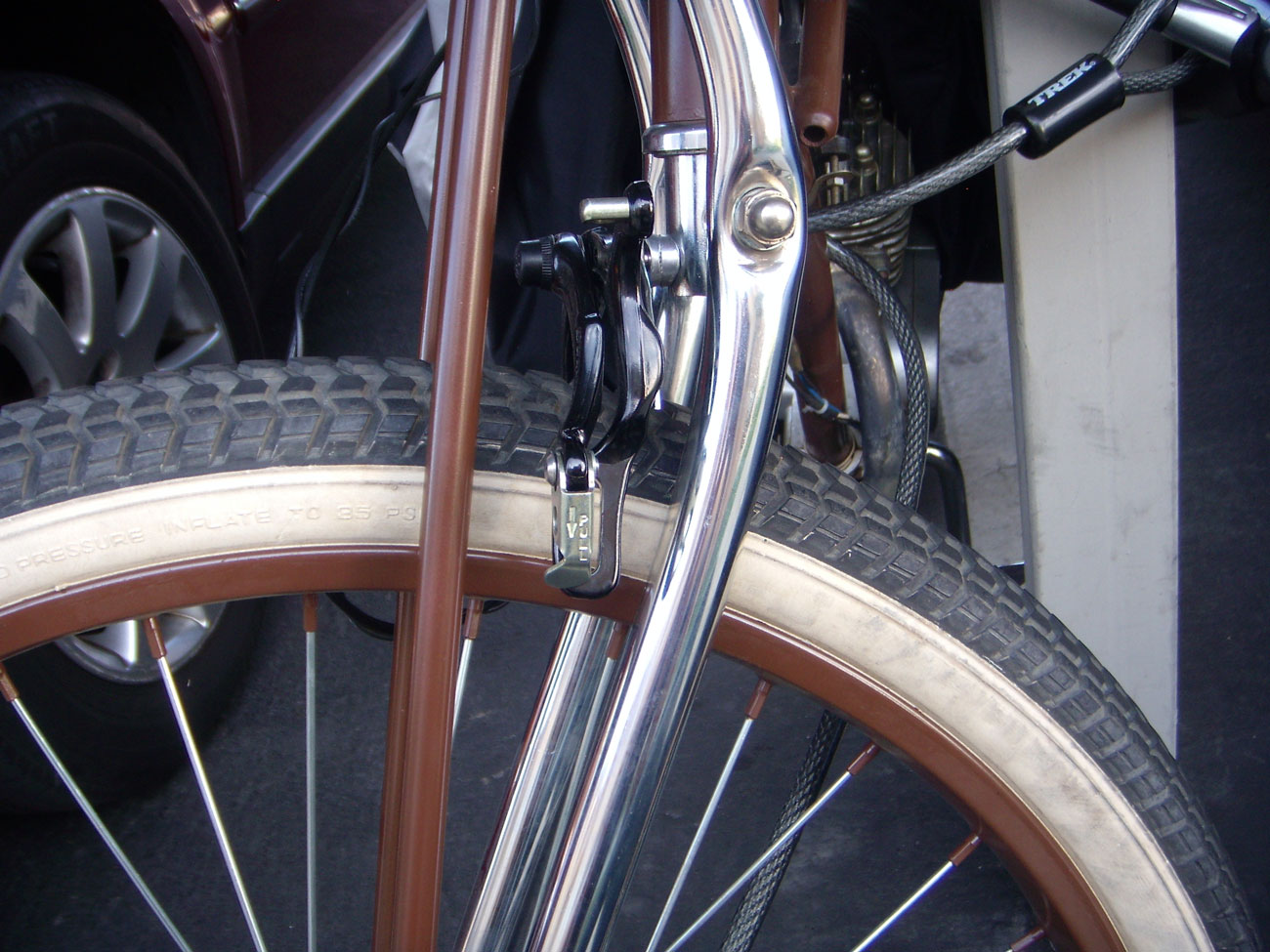

I had the same problem with my springer fork set up . I cured it by using 2 of the three C-shaped rag plates, that came with the rear sprocket . And bolted one on each side directly where the shoe would bolt on . Using the center hole in each plate . Then bolted the shoe through one of the end holes of the plate . If you have extra C-plates with your kit you can do the same for free . All this does is extend the shoes down and forward enough to make contact with your rim . Here is a pic of the bike I did this too .

I think your simplest solution is to get the bmx pyramid caliper brake from bikeworldusa... good folks to deal with, by the way. This has a nice wide and long reach and is what I just installed on both my 63 Schwinn Americans. Work great and was the cheapest solution for me. I also had just the rear coaster brake. As for your levers... all you would have is the clutch lever on the left and the brake lever on the right. I don't see where there's a problem with too many levers. That's how mine is set up and there isn't a lot of room on the riser type handlebars I use. Works very well for me. Good luck to you...

I think your main problem with the brake is the actual caliper design...not original to the bike, no doubt. The cheap solution:Brakes - Front and Rear Brake Cruiser Set | BikeWorldUSA | Bicycle Parts and Bike Accessories. I used this on my restored cruiser (with a springer fork) and they work/fit fine. They are made a little wider to fit around the wider tires. I also have fenders making it even wider to get the arms around...no problems. I too have painted rims and, yes, the pads will scuff and scratch. Nature of the beast. I only used the caliper in severe stopping situations as my main front braking came from a rear coaster hub brake setup.

OH, and lose the washer/spacer. There is nothing to grip the caliper to keep it centered with that thing in there. The first time you brake, the caliper will pull over to one side and stay there. If you get it to work at all.

wayne, i'm really liking that drum brake hub. does that operate with standard lever and cables? or do i need something else special/involved to get that on my bike? i already took the ill-fitting setup off, couldn't get over the washers. also, the springer/coil really is steep like that, it's not just the pic. it's been like that since i got the bike. is it supposed to be oriented otherwise? there really is limited space between fork and struts.
