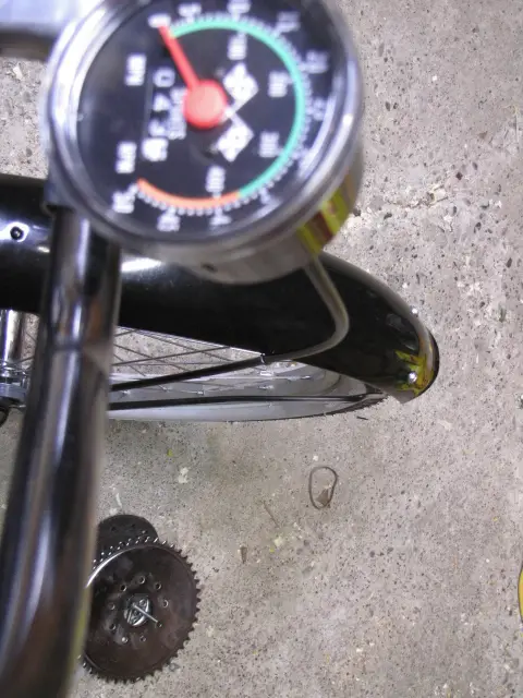

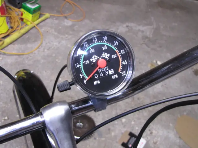

1. cheap speedo

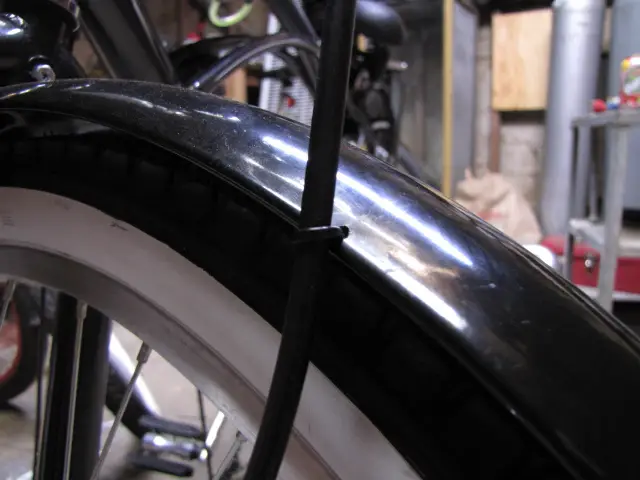

2. cable was rattling on fender
3. zip tied cable to fender

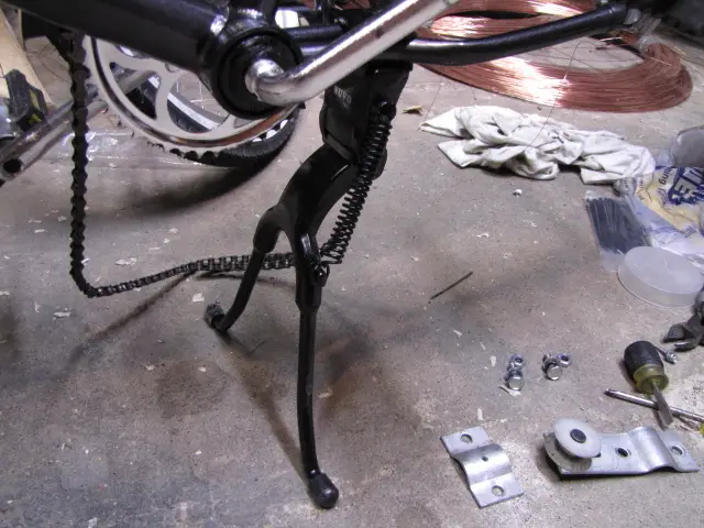

4. center stand

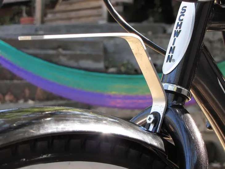

5. i was cutting a slit in my fender for my chain, and did a bad job (wrong tool) so i cut it right across i like it better like this now that its done
Name:	cheap speedo.jpg
ID:	11569   Click image for larger version

Name:	cut back fender.jpg

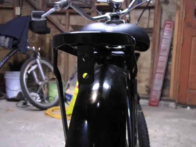

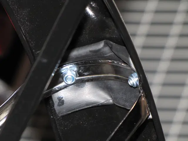

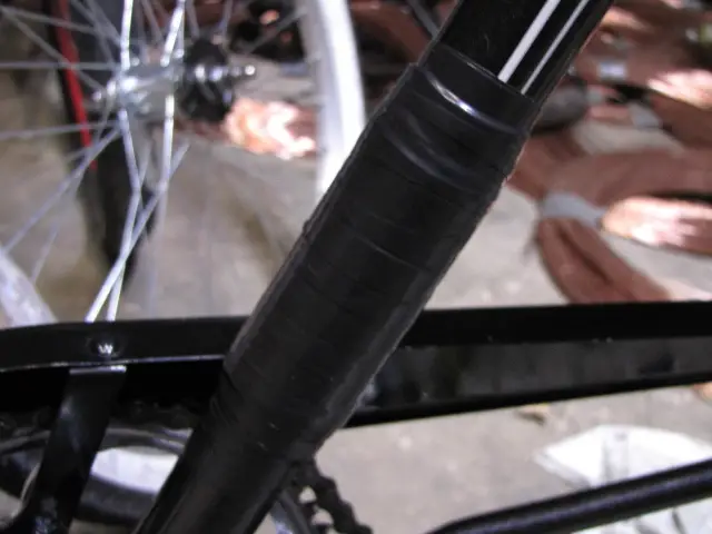

more info and pics

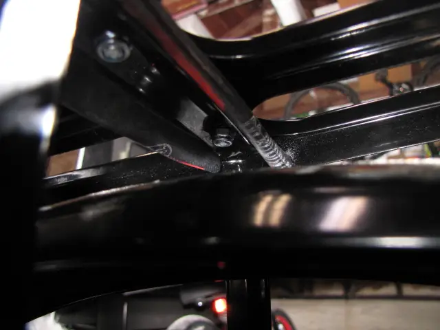

1. rubber under front
2. and back motor mounts
rubber sandwitched between:
3. rear rack
4. fenders
5. rack and fender arms

Name:	rubber undre rear rack.jpg

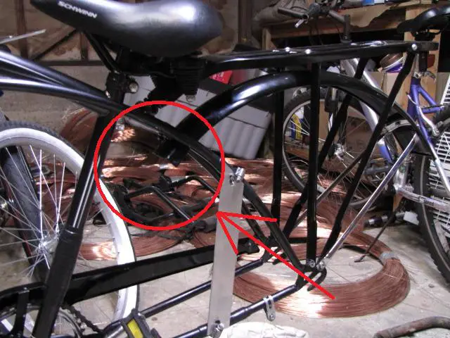

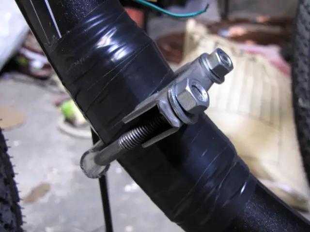

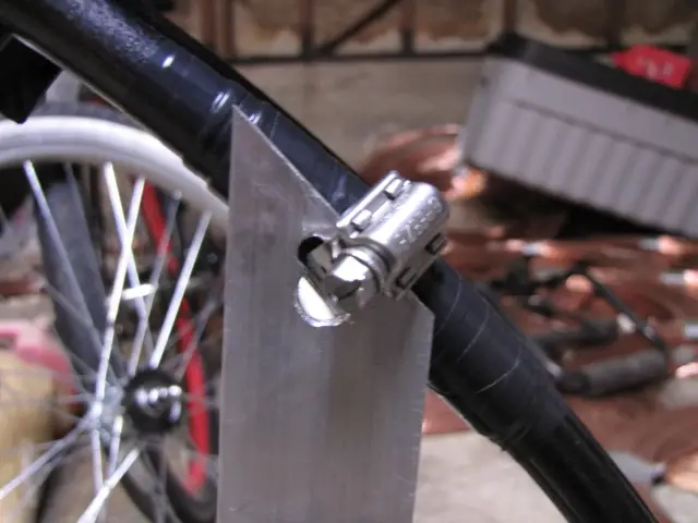

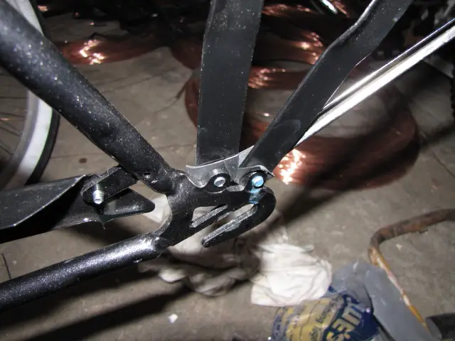

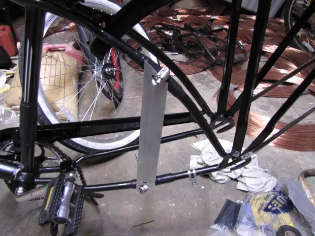

ok afew more pics
1. Norm's white wire tail light will be mounted here

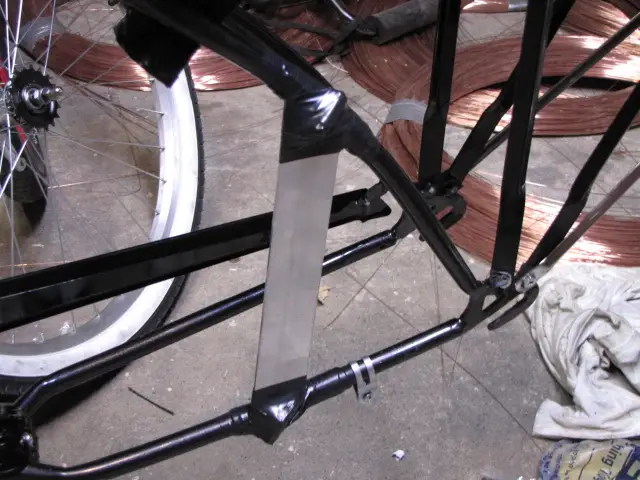

after about 40 miles with the stock idler i now know i want to make my own, i dont trust it so here i go

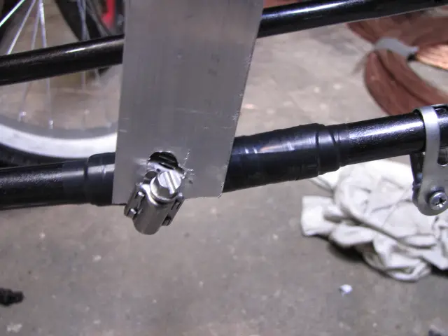

2-4 So i clamped an Aluminum bar 2" wide 1/8" thick to my frame (WOW thats ugly)
5. i gave it a face lift thats much better

Name:	cut and clamped aluminum bar.jpg

looks good, but be DAMN sure your fenders are stout. I have seen way too many pictures of nasty wrecks because of the fenders getting down onto the tire at speed. Its best to just remove them all togeather

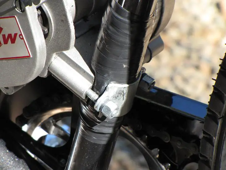

hey folks heres some more info

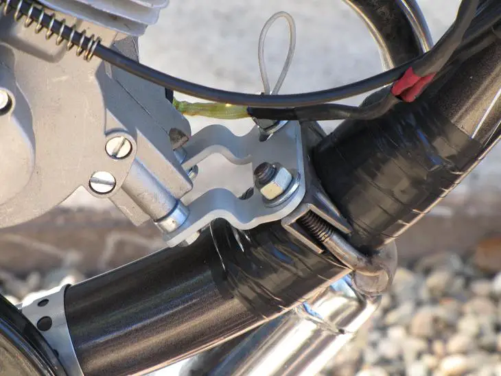

1. front motor mount
2. rear motor mount
3. headlight mount

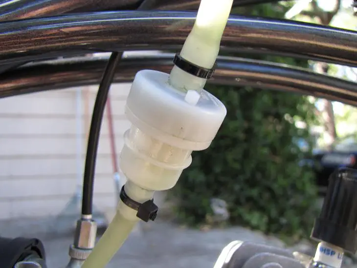

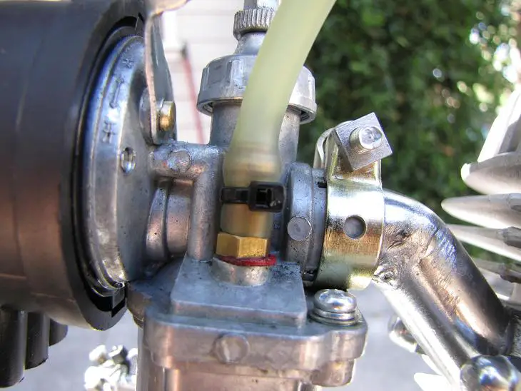

i had a leak somewhere from the gas tank to my carb so i ziptied everything
4. ziptie carb
5. ziptie inline filter

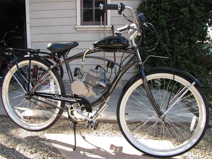

heres afew more

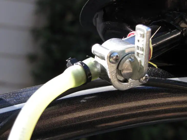

1. ziptied and put thread tape (made for fuel) on petcock
2. left side
3. right side

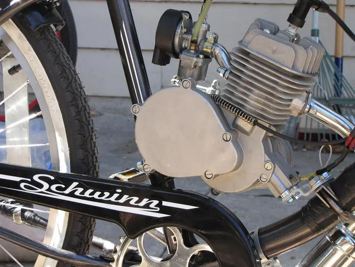

4. the Schwinn logo looks nice with a 66cc sitting next to it

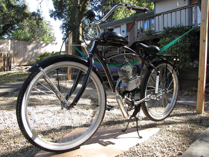

The front fender looks odd since it's on backwards.
