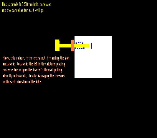

Impression, do you have enough thread left so that you can put a couple of washers under the nut so that it will not be where the stripped threads are??????????////

so, i believe the far right side of the barrel's thread is stripped.

well - other than drill & tap (my preferred method) there's these;
Threaded insert - Wikipedia, the free encyclopedia
Helicoils are bit of a pain - but sometimes the only option, partic for such a high-heat area, but you'll still have to drill out what remains of the old threads. These just make it so it's the same barrel size when you're done instead of oversize.
