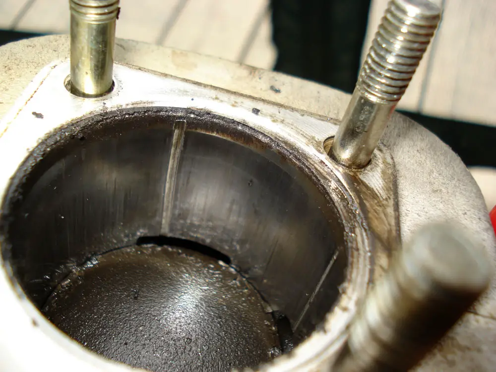

Take the head, top off the motor. Get the piston to it's lowest position. Is the cyclinder smooth? feel it. When rings warp or break they like to make scratches in the wall. Carbon, the safe way is WD-40. Let it soak for a while. We will go from there. Ya can't hurt it.

The cylinder wall seem very smooth no scratches that I can feel
your cylinder has a nasty scored area right above the port looks like a ring or keeper might of went south that looks bad!
Norman

Looks to me like you have a badly scored cylinder there.
Stick a fork in it, it is done.
