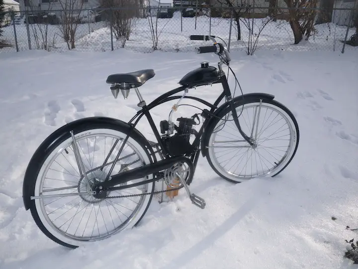

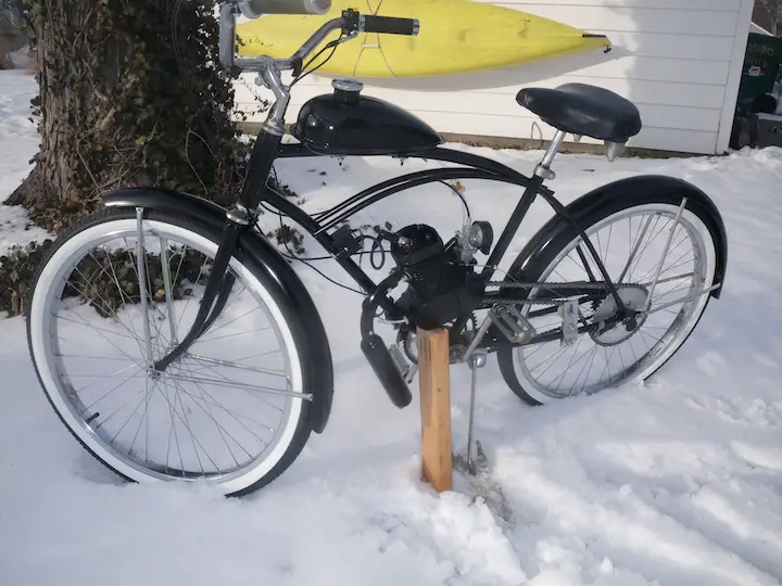

does this look like to much angle on the chain tension device,...?
I felt one more like and the chain would have been to tight,..
and taking out 1 link 2 many kind blows I'm sure,...
this is my first bike,... had fun building it, getting ready for the first run,...
any suggestions,...?

If you got the rear sprocket running true no side to side and no up and down wobbling then you should be good to go.
<-----top chain run going to engine --- open ends of mater link-->this way
ooooooooooooooooooooooooo----> open ends of master link clip
the oooo are the chain the <---> are the direction things should point.
I'm tooo lazy to try and find the photo so I hope this helps.
Norman
norms-iron-works.tripod.com

the chain tentioner serves 2 functions......
keeping the chain slack correct, and....
providing a directional influnce going onto the rear sprocket. your setting is too close to the rear wheel, in my opinion, not enough distance to do an alignment correction. about middle between tire and sprocket is good.
if your chain keeps comming off "to the inside" move the tention wheel bracket to the outside, and visa versa. try about 1/4" move at a time.
this is what i do with all my customers tentioners.....no more chains on the road lol

Good luck with the chain tensioner....
Personally I will never, ever use this type of tensioner.
It's a bad day waiting to happen.
My personal opinion.
