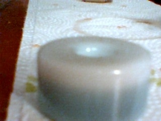

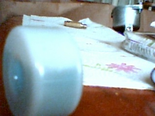

Is the float suppose to have gas filled init ? Like this ? Thanks I don't think it's suppose to also there is no gasket. Had fuel leakin g all over the place.
you have a dead float for sure need to replace that booger. No fuel should be in those ever.

No, it is not suppose to have fuel in it, it needs to be replaced.
