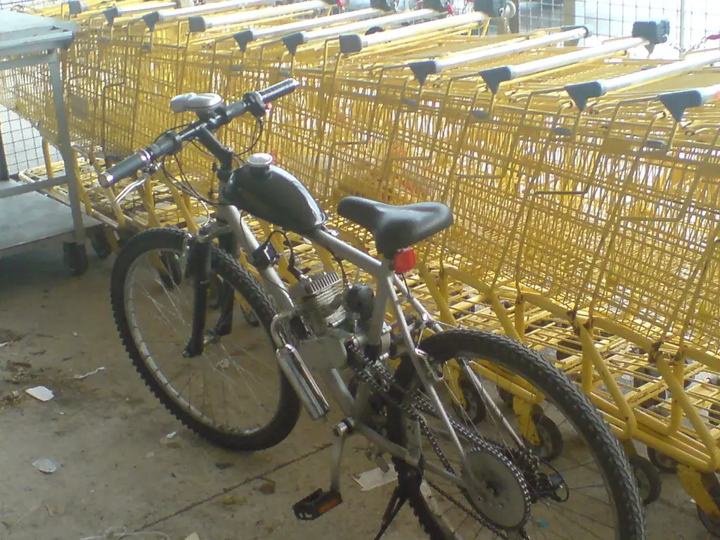

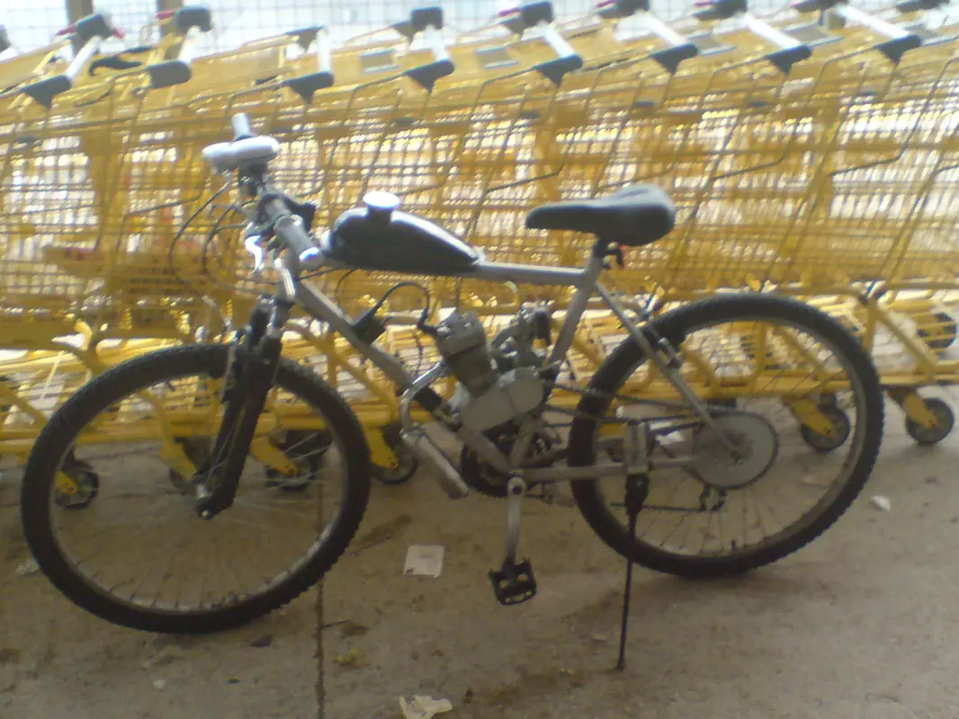

what do you guys think?

I think you did a great job.

looks like a clean install to me !!!
nice job

Looks a bit like my Mamba. I like what you did with the chain tension and kickstand combination. I might give that a try.

if you look closer the original kick stand that came with the bike snapped off when i tried to bend it, because it wouldn't hold up the bike properly, resulting in me dropping a couple times when working on it. i was gonna buy a new center kick stand, but the bolt is rusted on and wont budge!

Yeah, I can see it in the first pic. Well I don't have to worry about the kickstand anymore. I traded my bike for a broken Jaguar with and an 80cc.
Any issues with the the kickstand being that far back?

You've built a nice looking bike. Simple and clean and the install looks sound.
Here's a link to a center stand that I've had very good luck with. Electric Bike Accessory - Heavy duty kickstand A bit pricy but holds the weight of a Motorized Bicycle just fine. Have you tried some heat on that rusted bolt? It looks like an aluminum mount? The steel bolt might loosen if you apply a little heat to the mount. Ride careful, have fun.

Nice work there Mike. Nothing personal Mike but I see a lot of people putting the chain adjuster
on the motored chain side. With more than a few stories about the stock adjuster rotating into the spokes at speed and ruining a perfectly nice day why everyone continues this practice ? I cut the chain to a length that allows me to tighten the motor side with the axle and run the slack adjuster if still needed on the pedal side.
