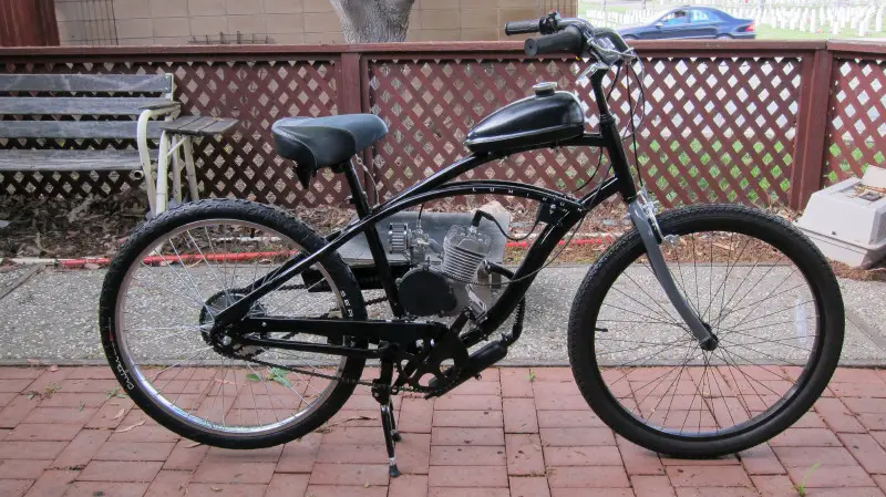

Work in progress. Starfire GT-4, steel wheel with 12g steel spokes, Shimano coaster hub and 22 tooth sprocket.
Went with the Sick Bike Parts engine mounts both front and rear after spending hours with various hardware store parts and being less than convinced re their reliability. The Sick mounts work good.

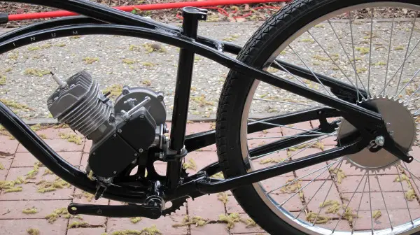

Custom exhaust done. I found that 3/4" copper fittings slip over the muffler pipes perfect. And that copper flex pipe fits into the fittings perfect. Just cut the brass ends off and you are good to go. The pic is right before I brazed it together. Not the whole thing, just the pipe. The muffler was cut off right where the bends started. I'm just going to put some slits in the couplers and secure to the header and muffler with stainless steel hose clamps. Looks good, follows lines of bike. Plenty of clearance frame and pedals.
The front mount is 1.5" Sick with the steel plate they give you with the motor kit, a 1/8" rubber pad and a 1/8" aluminum plate. 30 mm long socket head cap screws. You can see the copper pipe section I lined the front of the clamp with.
The rear mount is 1.25" Sick with the aluminum spacer they give you with the engine kit cut off so there is no more groove, 1/8" rubber pad, 1/8" aluminum plate and 40 mm long socket head cap screws. Copper backing the clamp in front and one of the steel plates from the kit in the back.
I like it. Now on to the wiring.

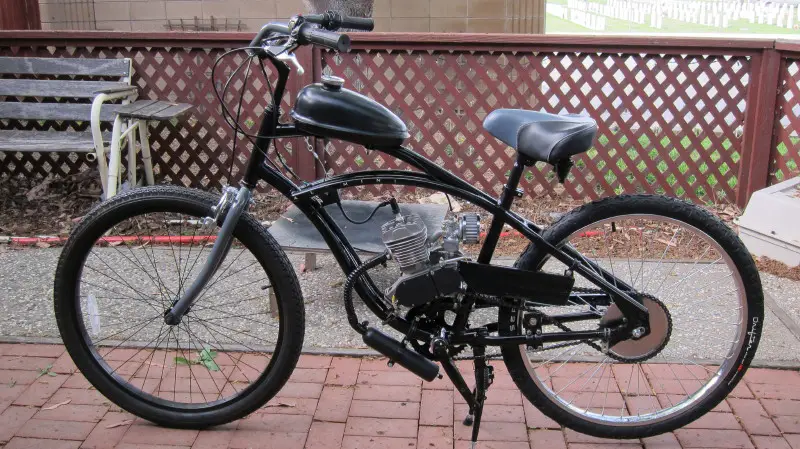

Thanks, I think so too. I've got a lot of hours in it...
Here's the flip side.
I think it needs a little roundy on the chainguard. A little more dremel work.
