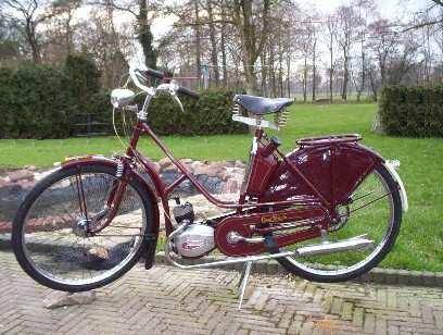

Posting this here because this is kinda gonna be a DIY CG. I bought several of these things when they first showed up in the US market and little was known about them. Im sure I must have gotten the worst of the worst as I found them to be miserable(but cute) little monsters and soon eliminated them.
Fast forward 7 years(wow!) and Im willing to gamble these things have improved, and I can work out any kinks. So yesterday I received a 66cc Flying Horse. My fisrt impression was it has improved a bit but the castings are still second rate(or worse). Things were totally assembled and torqued where it mattered and I didn't have a hole in the cylinder like one of the first. Still theres flashing in the ports and the hardware is crappy.
So how to make it my own? I want an engine for reliability(I know thats not a word associated with the CG). So on the critical fasteners I am installing helicoils and SAE hardware and will re-tap the rest likewise. I also bought a reed intake because I want good low end operation. I am targeting a 20- 25mph speed for cruise to stay in the smoothest zone of the band. Bought a 12v output mag. If it will fit I plan on installing a pop up compression release to make starting easier. Im also not opposed to lowering the compression a bit.
Will run the NT carb because they work and its all I need. This engine is going the opposite direction of most CG modding.
Was gonna install this on my 1953 Scwhinn Meteor frame but it just doesn't fit.
It does however fit my 1970 Western Flyer step thru like a glove, so the build will base around this bike.
Wish me luck!!
