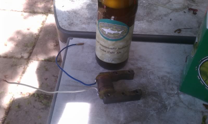

I left my multimeter at work so I can't do any tests till I get home later. Anyone care to take guesses at what failed? I'll post what I found to be the problem, I should have a replacement for every component.
I use my white wire, I have an ngk plug, I was using the stock wire and boot still. 175 miles ago had a bearing fail that beat up my mag and rotor, but they have not been a problem yet, so I kept using them.
Here's what happened. 15 miles wot (30-35mph)nearly the whole time, 10 min break, 15 mile return trip, providing the same throttle. About a mile from home after a red light and a turn, she gave an erratic poppy mess of firing, during the turn she totally gave up. plug has great color. ground for magneto still soldered on. pedal home in shame uphill. The good news is that a sheriff tested my moped legality and let me go without incident in the first mile.

I've seen coils come loose from the armature after getting smacked due to a bad bearing - this can short it internally.

truth is, I was surprised it worked at all after the beating, it was really ground on the downstroke side. But, its been problem free until this incident. I only have one spare (used) white wire magneto in my box. I'm only guessing cdi because it "felt" like it to me, there is no evidence I am right. I have one very old one from a 49cc in my box that hopefully is good. I'm counting the hr. left before vacation right now...

Strange... I've lost 3mph since I changed the mag coil. I don't have a good reason for that. I did not change the rotor magnet. Hmmm.

Just for future info... The easiest way to check for spark is to remove the spark plug & also remove the boot from the wire, & spin the rear wheel (so that the engine is spinning too), & hold the tip of the wire near the engine head. (you will see a spark jumping the gap to the head)!
If you don't have a spark?, 99.99% of the time it's the magneto! (not the CDI (black box)). ;)

If you have an ohm meter, your dad will know how to use it, try this:
Use Low Ohm-Meter Scale About 200 Ohms
Magneto Coil
1) Check Ohms between BLACK wire and WHITE wire. Reading should be around 2 Ohms
2) Check ohms between BLUE wire and WHITE wire. Should be around 300-400 ohms.
CDI
Use Ohm Meter High Scale About 200-K
1) Positive lead on BLUE wire and Negative lead on BLACK wire should read infinite (no activity)
2) Positive lead on BLACK wire and Negative lead on BLUE wire. Should be about 130-150 K-ohms
3) Positive lead on Spark Plug wire and negative lead on BLUE wire. Should read between 135-155 K-ohms
Switch to Low Scale 20K
4) Measure between Spark Plug wire and Black lead. Should be about 2.5 - 2.7 K- ohms
As for keeping water/dirt out. Make sure the gasket is good or seal it with a small bead of silicone and fill the hole where the wires exit the case with the same silicone sealer.
Assuming you mean coil as in magneto coil...
I used this test to verify my magneto coil. my bad one had wacky readings, they would change as tested, so there must have been a short in the coil. My good one was still a bit wacky (maybe my meter has a problem) but came up very close to the figures. Give it a try, let us know what you come up with. Good luck.
As far a magneto killing a cdi goes, i suppose it is possible but doubtful. I can't say I've read of that happening. replacing that magneto is cheap and easy if all else fails.
