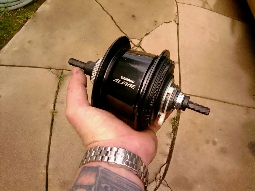

I'm using Shimano Alfine 8 speed IGH. Actually, this IGH has outlast 2 of my engines which got burned due to needle bearing failures. The thing about IGH is that your gear calibration adjustments should be as precise as possible and taking into account cable stretching. Also, try using low friction cable housing and cables, and make sure the cables does not snag or has a delay in response when shifting. The Shimano Alfine is designed for off road with triple clutch shifting, so I think it can handle the engine torque and power. Rohloff would also be good but too expensive for my budget. Next best thing is the Shimano 11-speed IGH.
I'm using 66cc HT engine with SBP shifter kit. I prefer IGH, because you can shift gears without pedaling, and keeps the chain in line.

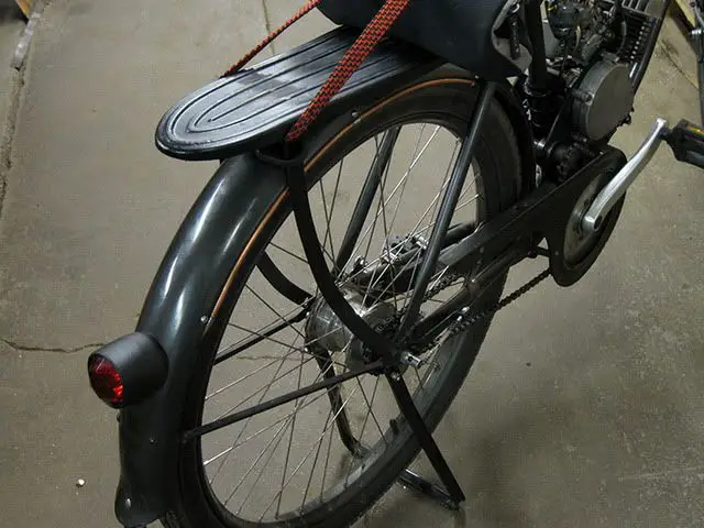

Pleased to report my comparatively inexpensive & simple Sturmey Archer X-RD3 3-Speed w/drum brake has held up beautifully for thousands of miles now :D

My shiftkit/Sturmey Archer X-RD3 3-Speed w/drum brake is pushed by a 66cc Grubee Skyhawk, lightly modded as here: http://motorbicycling.com/f52/basics-port-polish-port-matching-16646.html w/a SBP expansion chamber & a CNS V1 carby (apparently the only version to work well lol), the hub has well over four thousand miles on it now, but I also don't beat on it by "speedshifting" (not backing off throttle while shifting gears).
Any actual performance (speeds in certain gears) data would be greatly appreciated too (again don't forget to state engine size and/or mods). I know with small motors the top speed doesn't climb much with gears, but I bet versitility and enjoyment ratings are probably higher . PS Great pic BarelyAwake
Thanks :D
I don't bother to babble speeds save to say it's plenty fast 'nuff fer a 70yo bike lol, also gears don't increase your top end anyway - they get ya there faster (final gearing is final, regardless of how many ya used to get there) - if anything mutigear setups would be a tiny fraction slower in top speed than the same engine w/o as there's increased friction drag (bearings, cogs & chains).... provided the finals were the same ofc.
However, having ridden w/gears & without I'll defo include a jackshaft & gearing in any/all my builds - it's so worth the bother & expense. Not only do I think acceleration is critically important (getting the heck outa the way crossing a street/intersection/whatever) but it also provides a far more comfortable ride, the RPMs at cruise speed are greatly reduced as is felt vibration (no kit idler is also part of this).
Ya don't hafta buy a shiftkit (tho it is the easiest option), it's a pretty straightforward fabrication project if you've access to a welder, there's a buncha of DIY jackshaft examples on the forum if yer interested ;)
