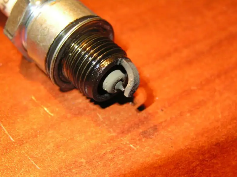

I took a pic of the spark plug, its a NGK BPR6HIX Iridium:

The motor is kite inclinated to the front, and the carburetor is not 100% horizontal, can be a problem?
What do you guys think about the spark plug color i posted few posts ago?
