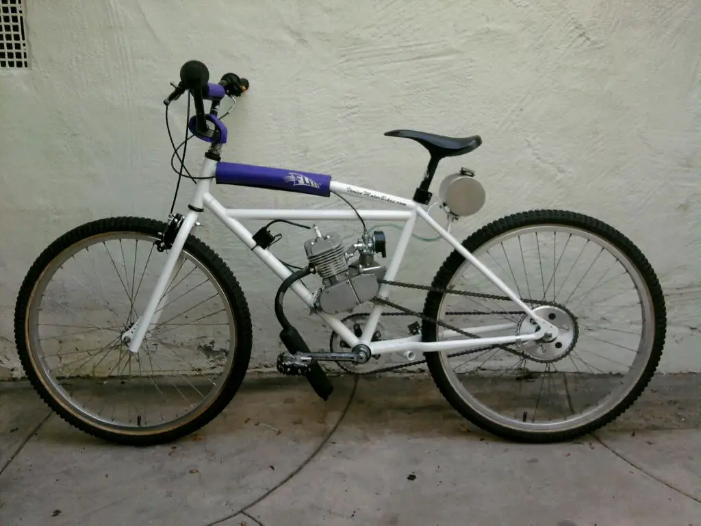

When I built the white BMX bike, I left it on because I thought it might weaken it if I removed it, & I might also want to put a kickstand back on it some day; (even though BMX bikes don't have kickstands.)
If you look close, you can see that I left it on... (& you can also see the new 'Sportsman' rear sprocket.) ;)

Ohhh, that kind of kickstand mount. I was thinking of the flat channeled piece like the cruiser Schwinns use.
Take Venice's advice. Leave it or at least replace it with some flat stock welded between the chain stays.
