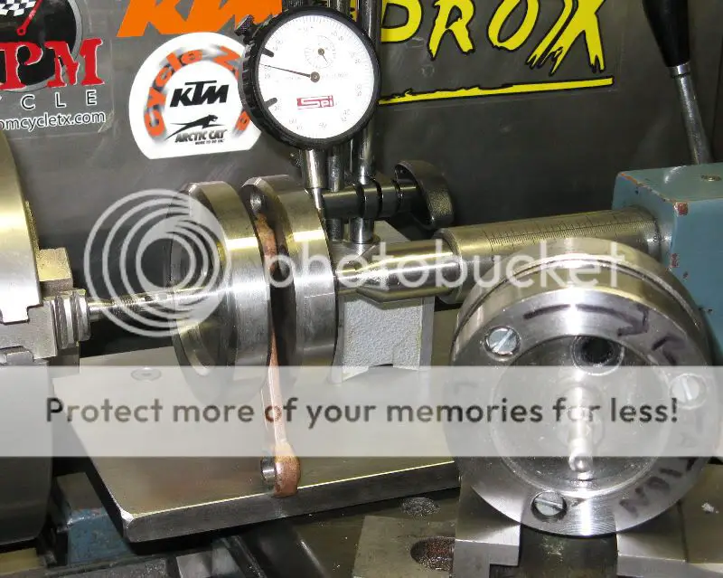

I sent 2 new cranks out to texas to get trued up he is going to send them back to me by monday and if all goes well i will post up his contact info heres a pic of his setup with my cranks..

actually i talked to him yesterday and the 2 shavts were pretty dang good but the webs were not concentric with the shafts. He is going to press it apart and machine them concentric. We are just experimenting right now i wont know anything till i get it back

ok so i got my cranks back today. The 2 piece was bent where the magnet mounts. No wonder that engine never ran right. the solid one is trued up pre rebuild left side runout was .002" and right was .003" post rebuild left side runout.001" as well as the right .001" crank width pre rebuild 1.736" post rebuild 1.738 side clearance pre rebuild .013: post .012" I also had the rod measured but dont feel like typing much more so i'll save it for a rainy day. Cant wait to see how it goes
