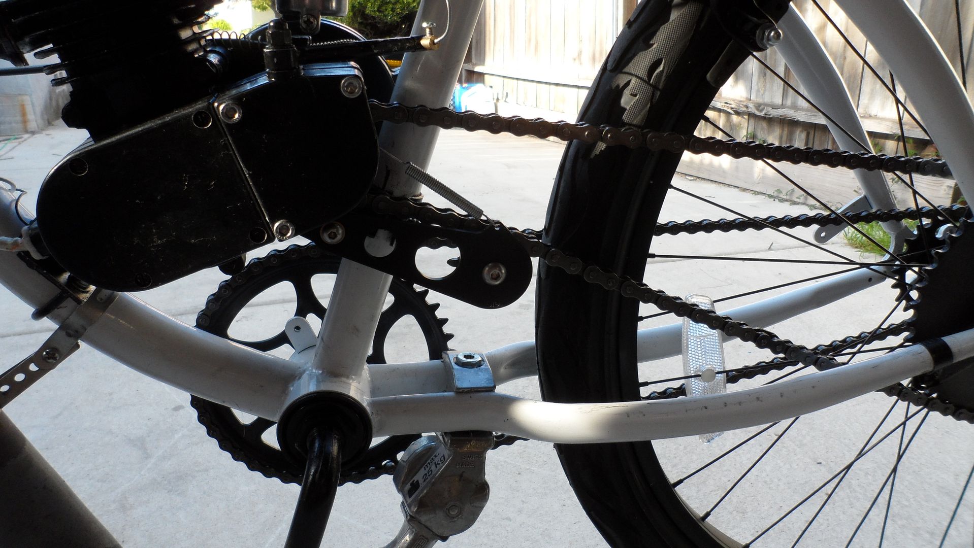

I had this happen once trying to start it
chain was way too loose
this was the first couple starts so I had no idea how tight the chain needed to be
I also have slight wobble in rear sprocket and ive tried to fix a few times
with that rubber connector its just too hard to try to set it perfect, or its my wheel causing it
I have the same tight slack, then loose slack in my chain when I spin the wheel but its barely noticeable
I have switched to the KIP tensioner and its a blessing
since its spring loaded it always keeps proper tension
even though its alot of money so far its worth it, plus it really reduces the rolling noise
I would suggest buying a half link and maybe tighten the chain one link at a time and check the tensioner
I also found if the stock tensioner was closer to the rear sprocket it worked better for mine but I was told to keep it near the engine. Thats where I had issues with the stock one
my KIP tensioner is on the engine and seems to be doing a great job, I got the expensive one with the little sprocket on the end, instead of using the stock roller
I know those on a budget probably wont get the tensioner, but I figure $100 is a good investment since my setup isnt ideal
Cheaper then having to replace the whole engine if the chain trashes it and not even accounting for any damage to yourself too

hey take a look at your tensioner alignment if you have tapered chain stays the roller may not be inline with the chain. I used thick piece of rubber to shim the mounting clamp (piece of old grip) after a chain dump and 3 broken links on one side I trashed the china chain it came with 410 and replaced it with garage door operator chain same size good quality and tough filed the burrs off the gears caused by the dump adjusted the tensioner angle and no problems since
