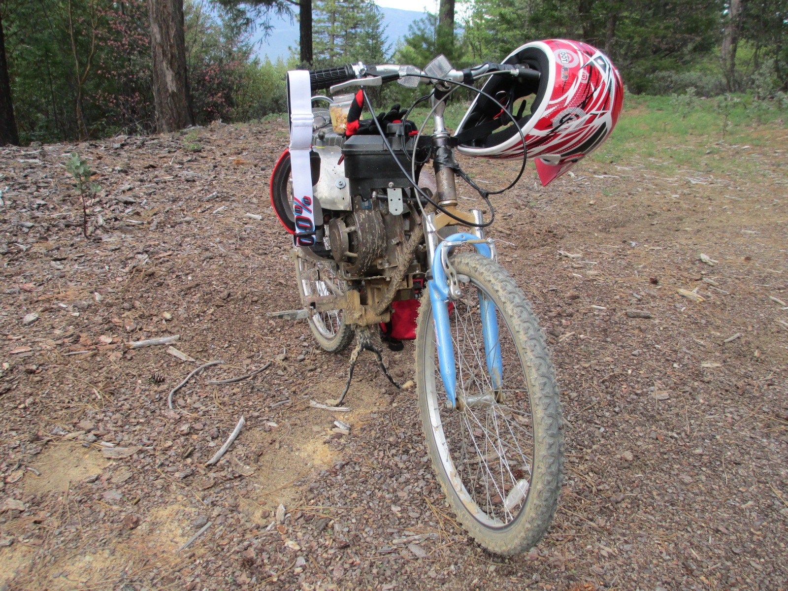

I've adjusted drop out slightly by cut and welding, but not the above. I wouold have but had only started welding when I was fitted the engine. Some put on a slant, but oil lubrication in crankcase must be considered if it can be done. I admit putting the engine on the platform I made for the engine has it contort to fit. Then the short spark plug has to have the screw top come off or the plug taken out and reinstalled after bolting down the engine.
MT
http://motorbicycling.com/attachment...5&d=1398150787 Mud holds it together!
