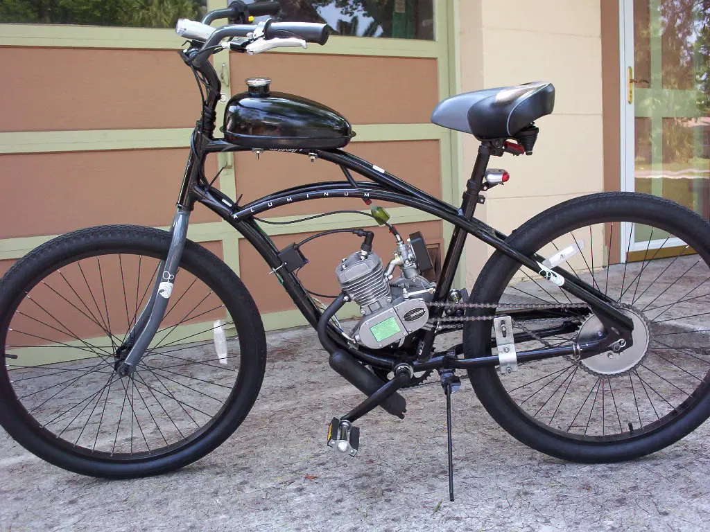

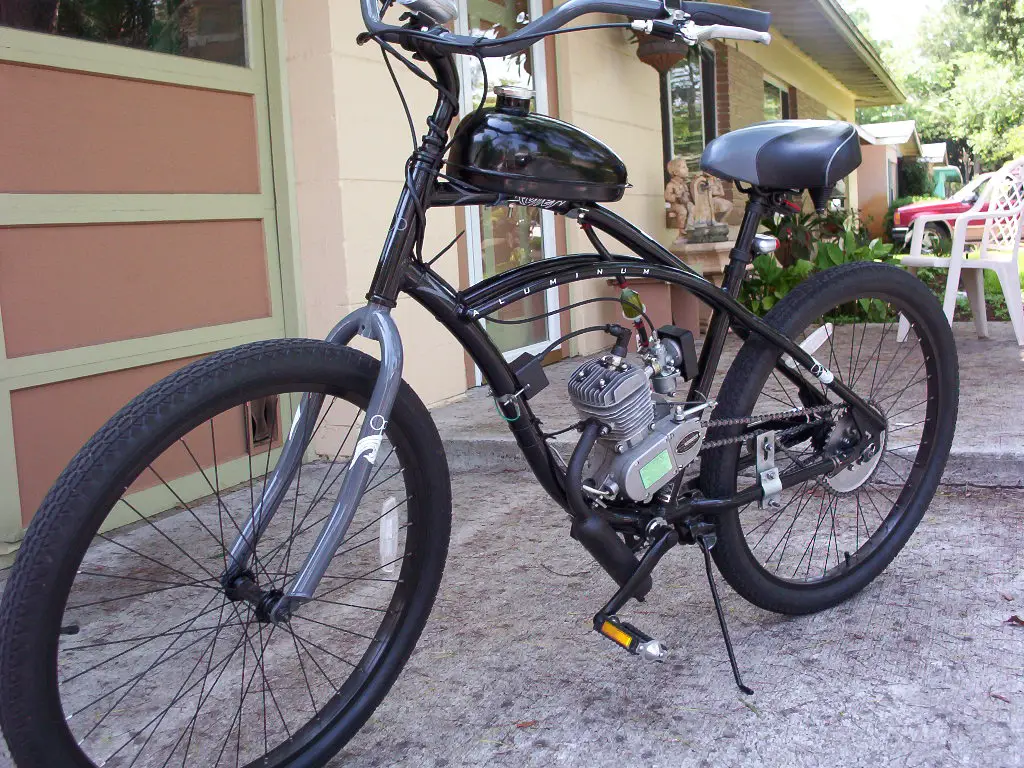

Flounder... sole... hahahaha.
Nice bike all but that god awful tensioner.
If you adjust the motor chain to fit without a tensioner you can mess with the pedal side.
Sometimes just a 1/2 link on the pedal side chain will do it with no tensioner, but if not put the tensioner on the seldom used pedal side, and paint it black.
Then you can do that pretty bike justice ;-}

Nice looking build. I agree with the need for a front brake. I've had kids, adults and cars all suddenly dart into my path. It tends to happen less when I burn my LED headlight during the day.
You dont have to spend a lot of money to have a useful front brake. A large BMX caliper brake should bolt right up to your fork.

That's the bike I am going to motorize . Did you use most of the hardware that came with your kit ? Did you trash anything ? How is your coaster brake working ? Any bending or other modifications on your coaster brake or muffler ? Any modification on your cranks , such as spacing them ?
Thanks kicking http://motorbicycling.com/f3/operation-op-first-build-progress-20028.html
Everything went pretty smooth.. I had to mod the the engine bracket for the vertical post. Basicaly sand it so it could fit flush to the oversizedframe , and remove the dust cover on the rear hub and chucked it to the trash.. I used the mounting kit that came with the motor. So the front bracket I drilled through the frame, but I used a 1/2 bolt sleeve to run the front bolt through. This prevented me from crushing the frame when i tourqed down on it.. also i upgraded the chain to a #41 . Last thing I did was put a pipe wrench on the muffler and twist it just a tad so it wouldnt hit the crank..

That is a nice looking ride..I agree about the front brakes though, You can set it up with a set of cruiser calipers for under twenty bucks.
Cheers
