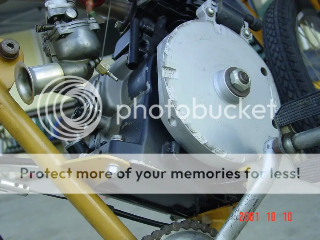

I've been running Briggs motors without shrouds for around 25 years with no overheating issues. Their fins are really overkill because the manufacturer knows the user will never clean the grass from them. I also like to re-design the shroud to make it fit nicer and protect my leg from the flywheel.

MSRFAN, how did you thread the shaft to get a retaining nut on? Also is it left hand thread? Working on a thing and want to cut off both sides of the shaft a bit and am not sure how to secure sheaves on both sides.
As always, great builds!

Thanks Dan. The shafts on Briggs motors are already threaded for a nut to retain the flywheel. There's no easy way to fasten a pulley to the right side. Some machine work will be needed. If I wanted to put a pulley on the flywheel side, I would have the a pulley bored to 1'' and then have a stepped nut made to slip through the pulley onto the shaft holding the pulley centered when torqued in place. Also a roll pin tight in the flywheel and a slip fit through the pulley would ensure it didn't unscrew the nut, and would allow easy removal. There's lots of different ways to accomplish the same thing. This is just the way I would do it. Maybe someone else will have a better way. Hope that helps. Let me know if you need a drawing or more info.
