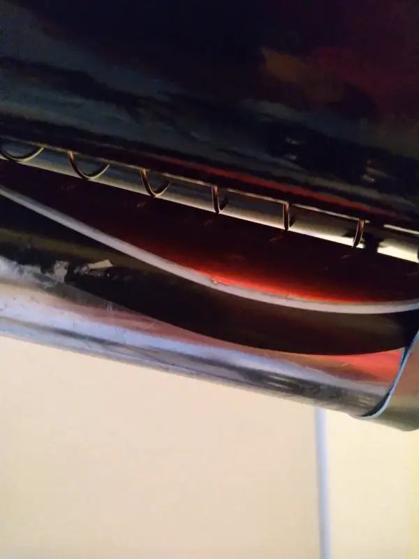

I just got a spring, about 4 inches
Long, stretched it out, coiled it
around the bare cables, like a cork screw.
Mounted the tank, it went better than
Expected, no cable binding, and tank
Is secure.
