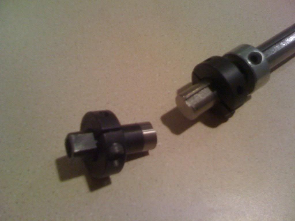

Is your spindle/crank combo too short and you need to extend them?
Well, I have to extend my spindle / crank combo since it was too short to clear the jackshaft sprocket. Extending the spindle/shaft below.
It's already 206mm long but not long enough. To extend it, here's what I came up with...
2 on each side 5/8" split shaft collar cut out my 153mm shaft, weld the too collars together and clamp both ends to the 206mm shaft. That's the plan. Pic is of 5/8" shaft 10" long if i want to go that route too.
I could definititely use one of these http://www.mcmaster.com/#8389k17/=s0hu9a
but I'm cheap and don't want to spend $34 for it, add shipping/handling fee and you're looking at $40. hahaha...

That should work as long as you can geth the weld to go most the way thru... bevel the edges up real good and I see no problems...
