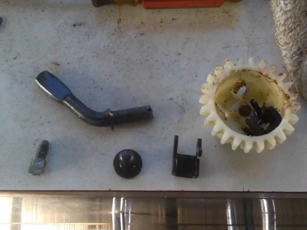

Finally, the offending parts (top to bottom: paddle, governor, low oil sensor):

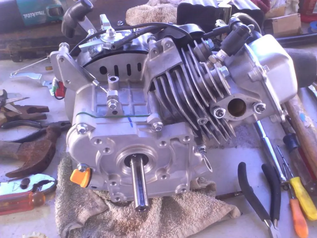

I just tore it out from the side shown... Left the gov gear pin in, and just have to plug the big hole where the bent rod was...Hopefully i'm good to go...
Got it back together after taking out gov..... I had no low oil sensor in there...Now to find a suitable frame and gather all the other parts I need...
