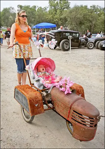

Im expecting my first child in April, and i plan on attending Greazefest (big hotrod/ratrod show)near the end of the year. I will be showing my Villiers bike there and any other bikes i have ready.
My girlfriend will be coming and we may dress up in vintage gear (a lot of people do) and i though it would be cool to make a vintage pram as they cost an absolute fortune to buy. I figure if i can make a half decent one i wont have any trouble selling it when i no longer need it.
Heres some examples of what i mean
http://www.google.com.au/imgres?q=h...5&tbnw=167&start=0&ndsp=21&ved=1t:429,r:1,s:0
http://www.google.com.au/imgres?q=v...1&tbnw=164&start=0&ndsp=22&ved=1t:429,r:0,s:0
http://www.google.com.au/imgres?q=v...tbnw=165&start=22&ndsp=28&ved=1t:429,r:3,s:22

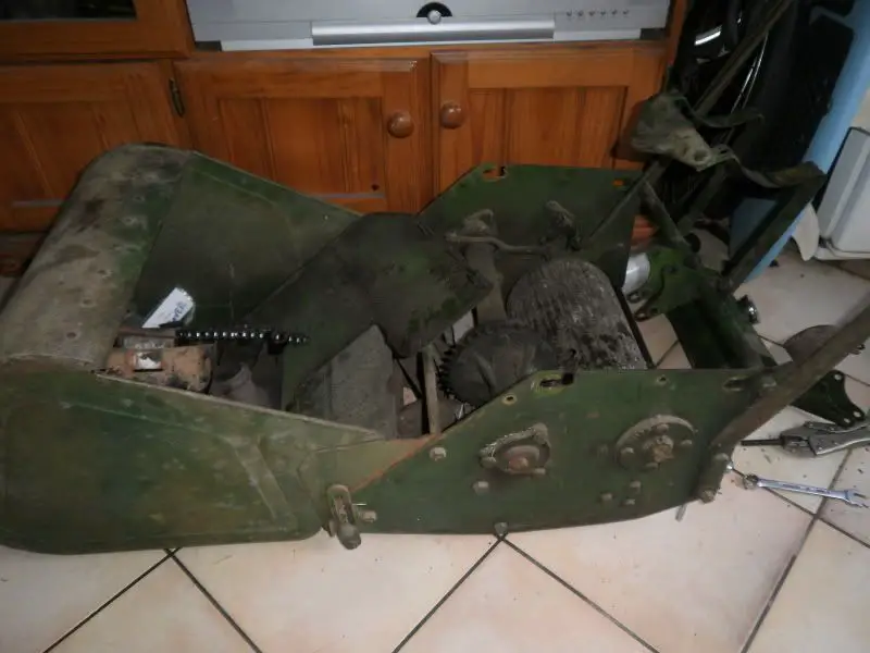

I have the catcher from the Villiers mower that i think i can use for the upper carriage section, i just need to lengthen it and close up one end, shouldnt be too hard, I have 2 x 20" wheels and 2 x 26 wheels that i can donate to this project.
The only thing im not too shore about is the spring part under the carriage. If i make it out of mild steel it wont hold its shape will it? Can i heat treat it for strength or do you guys have any other ideas how to make that section or is it a lot more difficult then i think, if so i could make that section out of tubing but it wouldnt "spring" though, not sure that would matter.
Heres the catcher that i plan to convert to the carriage section, recycling is so much more satisfying then just buying one anyway

Any mower parts like that in my area???? What parts do you mean? The leaf springs?
I can get free steel form work (around 50mm wide by 3mm thick in very long lengths, brand new steel only used to pack a felt) so i could try stacking them like car springs, i actually thought of that idea but not sure it would hold the "U" shape required for under the carriage. I guess i can try and see.
Failing that i think i could try your idea, using small diameter tubing bent into the "U" shape and hand coil springs to suspend the carriage. I bought a pipe bender and should have it in a couple of days so i can now do the bending no problem.

Im a little confused here Fasteddy, do you mean the catcher part in my photo of my Villiers mower, that IS MY catcher. I plan on stretching it and closing up one end with sheet metal that i already have, that should be similar to the carriages in the vintage photos, thats what i meant in my original post,.... or do you mean i should find another catcher the same and weld them back to back, that would be cool, but i havent seen a complete mower close by at a reasonable price for a little while. But i will keep my eye out.
And yeah i think i will try the steel from work for the undercarriage leaf spring section and see how sturdy it is and go from there. If it isnt ill look at strengthening it with bracing or extra leaves and add coil springs to hang the carriage if needed. Thanks for the help

the stroller looks similar to a David-Bradley garden tractor, and some boat trailer fenders.
the problem you're gonna run into, Harry, is the mower side-plates and other components are gonna be real heavy... basically, it was a good mower, and made to last!

RC, just checking, you do realise that i dont plan on building the ratrod style tractor-looking pram, i just included that picture because i thought it was cool. I plan on building a classic looking pram like the three links i supplied in my original post.
I will definitely keep weight in mind, when you say "side plates" you arent referring to the thick plates on the actual mower body are you? I dont in tend on using that part, just the front catcher section, its still reasonably thick metal but should be fine IMO.
Ive seen the "art-deco" style pram photo you showed me, i have seen it but it is cool. Ive spent quite some time looking at old prams on the net and i know what i like and what i want to acheive. I really like the big wheels, dont like the ones with small wheels.
Like you said this will probably only be used a handful of times.

Sorry, I was talking about the stroller that someone made out of the lawn mower front end and and fenders.
Steve.
Ahhhhh, no wonder that was getting a little confusing. I only supplied that mower looking pram as i thought it was cool, i want a classic looking pram, i think they are called "english prams" with really big wheels like in my original post.
