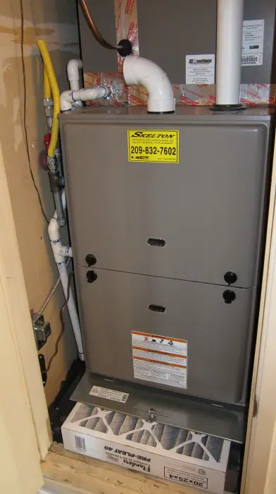

Here it is.
This is the "filter base". The whole 80 KBTU furnace / 3.5 ton evaporator coil stack sits on top of it.
Yeah, when I changed it after 6 months, it wasn't even dirty. Could have gone another 6 months.

40% efficient. No wonder you can run a 4" filter.
Commercial equivalent would probably be a 95% filter. Those would need hurricane force winds to get air through it.
Darn, Mike. What do those puppies cost each?

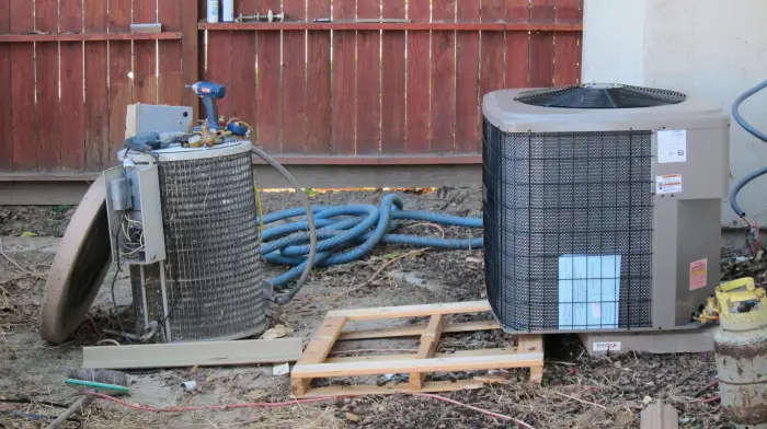

Yeah, My AC used to suck...
But not any more - :)
95% efficiency condensing furnace and 15 SEER AC
I think the new condenser unit is a bit bigger than the old one eh?
